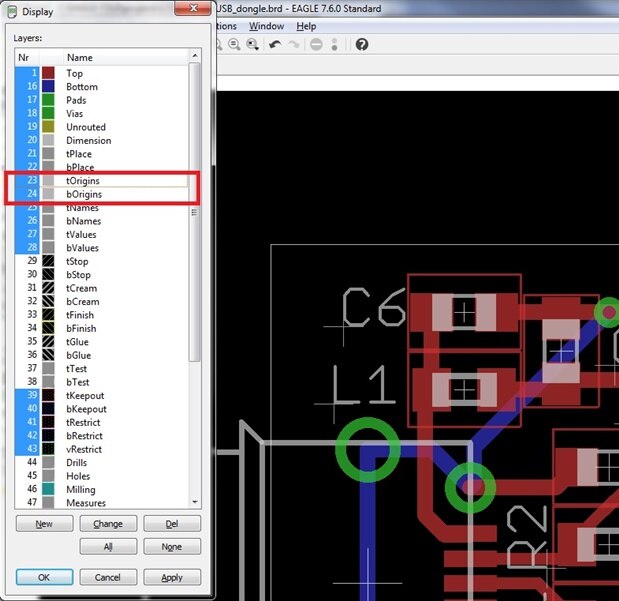

Hello,
I am new to Eagle and I just finished laying out the PCB I designed.  In the process of cleaning it up aesthetically, I deleted all the names of the components on the board so they would not appear on the silkscreen when it is printed; however, now all of the crosshairs for the components are gone and I cannot move anything on the board.  I cannot "undo" the action of deleting the names because I closed the program after I did so.  Any suggestions?
Thank you.
    0 genebren over 7 years ago
    Kyle,
    Make sure that the tOrigin and bOrigin layers are enabled for the crosshairs to be visible.
    Good luck!
    Gene
