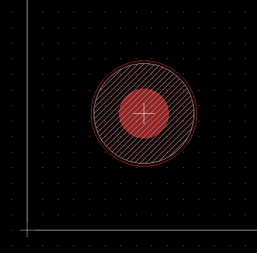

I use a 0mm width circle place on top, and larger circle place on tStop , tKeepout and  tRestrict, to make a package as MARK point.
but DRC can't check out errors..
can someone give me some advise?

    I am not sure what you want to do or what you expect exactly..... could you explain your problem again, please?
    For an example how a marker can look like, please check marks.lbr.

    I want to place a MARK point for automatic placement(mount) machine. it need a reference coordinate.
    like this:
    now I know where is my mistake, the  color of  layer tKeepout and tRestrict  is too closely ... sorry.
