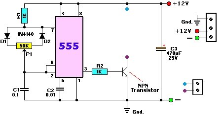

Second, let me show you up front the schematic I am trying to build from:
http://www.reuk.co.uk/OtherImages/ne555-pwm-led-dimmer-circuit.gif
I am trying to modify this schematic so that the LED String can be remotely wired via a 2-screw terminal block, and the GND, --, and +12V all go into a 3-screw terminal block.

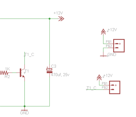

So essentially this:
What is happening, when I try to net any of the components to multiple points, a window (Connect Net Segment) pops up forcing me to choose only 1 point to link to, so when I switch from schematic builder to board builder, the airlines vanish.

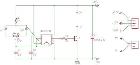

Here's what I have on the schematics screen:

    Why did you add a -12V supply?
    As you drawn in the second image, the GND and - is connect together.

    I was just trying to use supplies that closest match the circuit I was working from.
    I know the GND and - are connected, the problem is, when I connect the GND to the the - net, it makes me define the whole net to one or the other, and when I switch to board view, whichever one was not defined vanishes.

    0 huayuliang over 16 years ago in reply to e14 Contributor
    some thing you should know, one net only can have only one name, that is label in EAGLE.
    it is not allowed connect two or more supply on one net.
    if you need place some comment on sheet, you should use Text command.
    Perhaps you misunderstood "net" or confused two thing.
    so though the GND and - is same net, you can only use one name (or label in EAGLE).
    in the original figure, there isn't a -12V net, maybe you means that is - net. but there is already a GND net, no need other name.
    so you only need a two terminal connector, not a three terminal connector.
    I modified your schematic, show in below:
