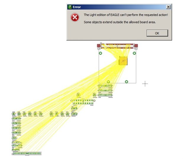

Hi.  I have eagle 6.2 free.  The board size I am using is 35mm X 27mm.  I can increase the size of the board to 50mm X 27mm but when I move an object (device) into the newly created area I get the error message: "The light edition of Eagle cannot perform the requested function. Some objects extend outside the allowed board area." Any ideas appreciated.

    the components and signals have to be inside the coordinates range of (0 0) and (100 80) [mm]. Maybe your board is - at least a part of it - in the negative coordinates area?

  • stp715a
    0 stp715a over 13 years ago in reply to Richard_H
    THat was it.  Stumbled onto it last night.  Thanks for your quick response.

    I am having similar problems with my board layout in Eagle cad light.
    I drew the schematic and when I switch to the board layout, and attempt to move any part of
    the design into the board area I get the error shown above..
    Eagle cad is dropping these parts outside the board area and then not allowing me to move
    them within the board area.
    How do I fix this?
