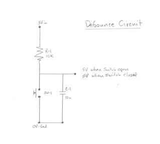

    0 jw0752 over 11 years ago
         Your summary of the circuit described by Hampton is correct. This would hold your input pin high with the resistor until the button is pushed and then the pin would go low. The only side effect is that most switches bounce (turn on and off for a few micro seconds) and this can cause problems for some logic circuits. Above I have drawn a simple debounce circuit that will help to eliminate the bounce effect. This circuit also holds the input high until the switch is closed. You can also rearrange the circuit so that the input pin is held low until the switch is closed if this better suits your needs.
         Electricity always flows from a higher potential (voltage) to a lower potential. If two pins are at the same voltage, whether it is high or low no current will flow. Therefore you can be confident that all the pins that are tied to the ground will have no current flow between them. Likewise all the pins that are high at Vcc will have the same potential and no current will flow between them either. I do not know what type or specific chip you are using but for the most part they are pretty forgiving of having their inputs and outputs pulled high or low. It is important that the power in Vcc and ground 0V be on the proper pins. Also most circuits are quite sensitive to high voltage static that can be generated on your body by moving or walking. Be mindful of proper grounding procedures so you do not destroy your components.
         The above circuit can be further improved by adding a Schmitt trigger or two on the output.
         Hope this clarifies our answers for you.

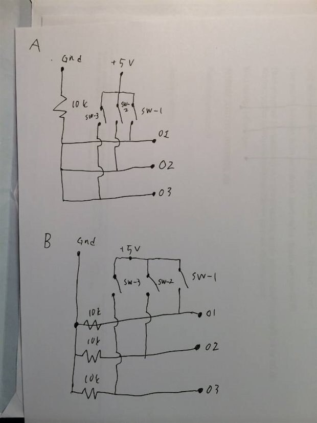

    It answers alot thank you! I drew my own sketch with 3 switches isntead nad 3 outputs, I want the 3 switches to only affect their given output, SW-1 affects O1 and so on, I got a feeling that B is the most likely correct one as it would make such resistence for current to move up any of the others that it simply won't but please do tell me if either one is correct, none or it simply doesn't matter. Open = Low, Closed = High for this circuit
    [URL="">i1310.photobucket.com/.../URL" rel="nofollow" target="_blank">s1310.photobucket.com/.../URL]
    Also what are the exact grounding procedures?

    0 jw0752 over 11 years ago in reply to Former Member
    Hi Zelos,
