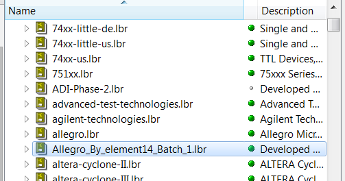

I have added the libraries available on the Cadsoft website from CAD Library section and I still don't see it in the ADD window.
For example:

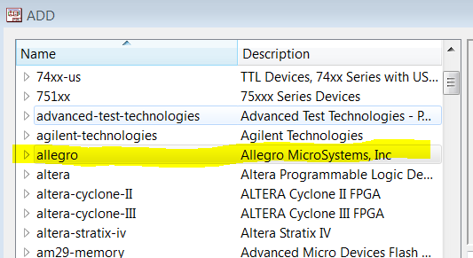

I have downloaded the library file that is Allegro_by_Element14_batch_1.lbr and added to the library.  In the library window I right clicked on the library and checked use, that turns the green dot ON the library.  Even after that when I open Add (symbol) window in the schematic for adding the part to my schematic.  I still don't see the library in the ADD window but I can see it in the library.  Do you know what I have to do make it visible in the ADD window.

    I figured it out
    The following is the link where Jeremy explains how to update the added library.
    Tutorial 1 for CadSoft Eagle: Schematic Design | JeremyBlum.com
