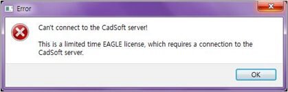

  • Richard_H
    Richard_H over 13 years ago in reply to 권슬아
    Hello again,
    well the second image you posted in your recent email tells me the missing detail......
    You are working with a time limitted version. Such a license needs an internet connection in order to work. The license checks its validity on our server. I am sorry that I did not realize that your license is in fact timely limitted. Without internet it is not possible to work with it.
    Regards,
    Richard

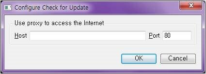

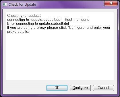

  • 권슬아
    권슬아 over 13 years ago
    Hello,
    This massage popped-up when I clicked onto Configure
    and, This massage popped-up when I clikced on to Cancel..
    What should I do..?
    Thanks & Regards
    sra
  • Richard_H
    Hello,
    please click onto the Configure button and swith off this check.
    Regards,
    Richard
  • 권슬아
    권슬아 over 13 years ago in reply to Richard_H
    Hello,
    Richard...
    I has Clicked 'OK' button.
    But continuously that Message is popping-up
    so I can't use EAGLE without LAN..!
    HELP ME..
    Thanks you.
    Regards
  • Richard_H
    Hi,
    as the message says EAGLE wants to check whether a newer version is available. If this would be the case a message would be shown that tells about the new version available. If you don't want EAGLE to check this you can configure this.
    It's no problem to have no Internet access. Without, simply click OK and that's it.
    Regards,
    Richard
