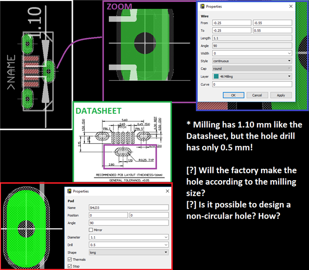

Hey guys,
I'm having an issue with a micro USB type B - USB-MICROB-1051330011.pac available on we-con.lbr ( 1051330011 Molex, LLC | Connectors, Interconnects | DigiKey )
Micro-B USBI've tried to sum up my question on this image:
If we open the Package of this element and using the pad from the datasheet with a purple rectangle we have:
- Rectangular hole with 1.10 mm AND two semi-circles of R=0.25mm
We have this structure with the Milling Wire, but the hole is 0.5 mm.
I've tried to change the hole of the pad to a non-circular element, but it does not seem possible.
Questions:
1) Will the factory make the hole according to the milling wire?
2) Is it possible to design a non-circular hole? How?
Thank you very much in advance!
