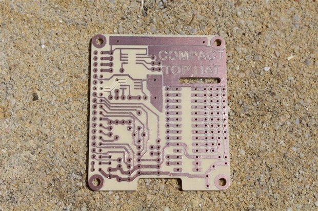

    Hi Captain!
    I use my own asymmetric connectors for single sided boards to give the pads maximum adhesion.
    Put letters on the signal layers to have them on the copper layers.
    Cheers
