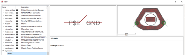

    faad021 over 8 years ago in reply to genebren
    Gene,
    thanks for the help and i appreciate. I came up with something and i hope it works. Even though from the datasheet, the inner diameter of the ring is not given. I am still an amateur though in creating a library and is actually my first time doing it. I simply inserted smd pads around and in the middle.
    I am actually not yet done and just wanted to know if i am on the right track.
    Thanks
    genebren over 8 years ago in reply to faad021
    Leroi,
    The library component that you are showing is very close.  The outer ring (with what look like unplated holes) has contact points (non-masked pads, near the holes) that the smaller domes will make contact to.  So in this model, the electrical contacts are all on the surface of the dome (outside and inside) and the legs are only for stability.  The leg positions and the pads will have to be adjusted (holes are not on center-line) and there are three non-masked areas to make contact to the outer edge of the disk.
    Gene

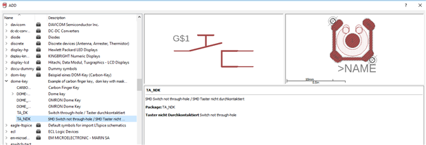

  • faad021
    hi thanks for the reply.
    This will be of course helpful. So basically the second leg is just for stability and plays no role.
    I also found this library(dome-key.lib)  but am not sure if this would be help.   I though of using the inner circle as one contact the outer as the second.so the legs will just be there for mechanical stability on the pcb. I am not sure if this can as well work.
