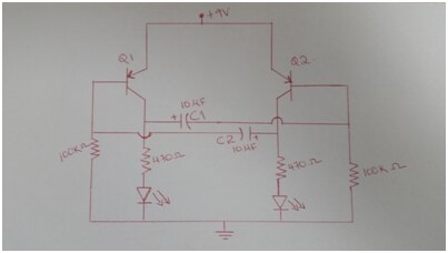

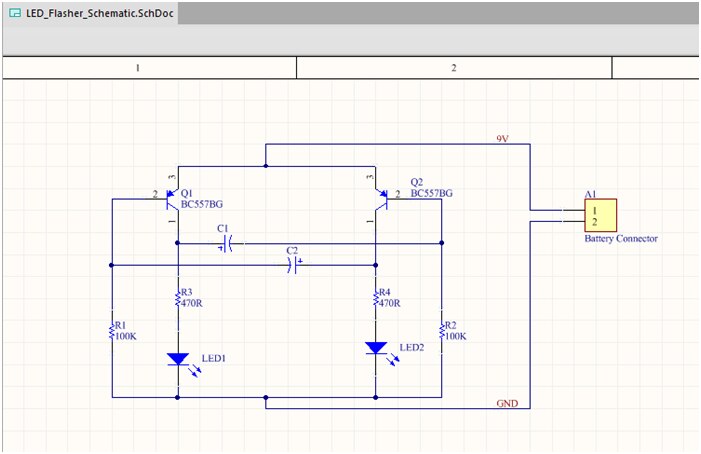

Get your “paper made” design. I’ll use a simple LED flasher based on transistors shown below:

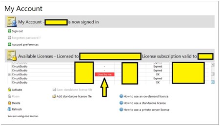

Now, start up Altium Circuit Studio and make sure you atleast have a trial license from element14. You can check this from Help → About → My Account. It should look something like this:

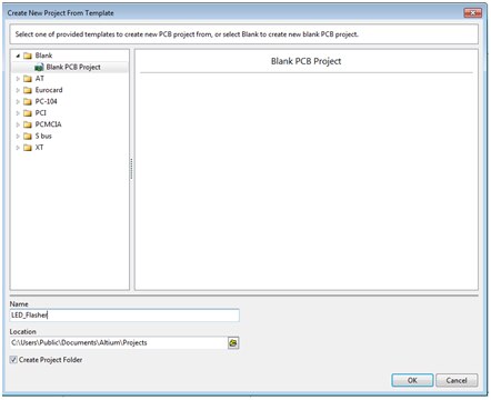

Start a new PCB project from File → New project → PCB project. I’ll choose a “Blank PCB project” type and give it a name “LED_Flasher”.

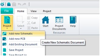

We’ll now proceed to add a new schematic file into this project to “draw up” our circuit on an A4 size sheet. Click on “Project” and “Add a new Schematic” into the project.

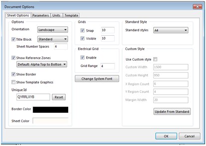

Once you have the blank schematic in your project, it’s time to set some options for “Grid size”, “sheet details” etc. Let’s go ahead and do this. Click on the “Project” tab on the top & on the Ribbon menu (i.e. the one that populates when you click on “project” tab), click on “Document Options”. A window showing you all the options for the schematic opens up like below. Set the “Snap grid” to 10 mil for now.

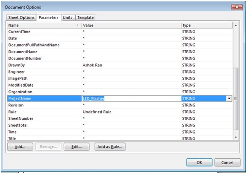

If you want to set other document parameters such as “drawn by”, “modified date” etc, go ahead and enter these as strings in the “Parameters” tab. If you want to set standard units to be used across the breadth of the schematic, set these in the “Units” tab. Once you are satisfied with exploring the options, hit “OK”. My document options look like this:

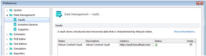

Oh, and by the way, if a vault is not installed already with your installation, you can manually add a vault from File → System Preferences → Data Management → Vaults → Add Altium content vault and use this URL: http://vault.live.altium.com and tick the  “Enable” box. Like this below:

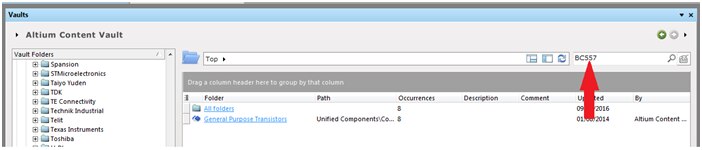

Now, you can “consume” the vault content. Open up the “Vault explorer” from the “File” menu. Type in BC557 in the search box and you should see all matches. Click on Transistors folder and select the most appropriate one you feel is OK for your design. I have chosen my best match and what I see is below:

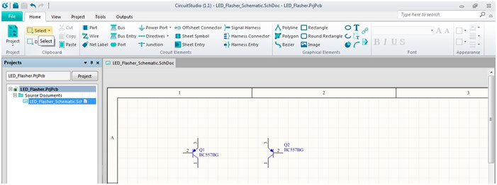

Now, drag-drop the component into the schematic. Directly from the vault. Go ahead and drop 2 as we need 2x for our design. Similarly, find the other components required for the design from the vault and drag-drop onto the schematic file. My schematic looks like this. To get the part designators (Q1, Q2 etc) and set the orientation of the components, double click on the component to open a dialog box where all these parameters can be configured. I’ll now go ahead to drag-drop all the remaining components from the vault and my local library.
To access the local library, right click on an empty space in the schematic, go to “Place part” and click on “Choose”. This will open up the locally installed libraries on your machine. You can also use this for any parts you need.
OK, if you are done, it should look something like this. The 9V and GND are “Net labels”. I found the connector as “Header 2-pin” in the local Miscellaneous Connectors library.
