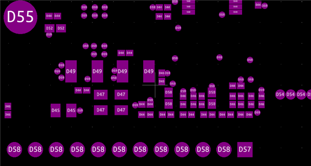

I have generated a design which uses via.
When I do the Gerber export I get a anti mask on the silk mask layer, so the via will show metal when built.
With BGA I have had far too many shorts if I do not put silk mask over them. I often leave the hole of the via as metal, as some fabs don't like that.
How do I make the mask on via's not appear on the silk mask layer outputs?
This to me means CS is not usable for BGA devices?
In Altium Designer you can set the tenting on the via as a rule.
Is this possible in CS, Sorry just started using it so not really sure where to start to have a go at fixing this.
See this pic with the D59 code appearing on the vias of the solder mask layer.

    Hopefully, someone with more experience using CS rules can help.  I know you can select the vias you want to tent and do them individually or as a group with PCB Inspector.  There is also a rules wizard that helps define rules but it doesn't allow you to add all the rules conditions that AD does.  Therefore, you cannot add the IsVia keyword or InNet or others I sort of remember from my AD days.
    However, if you know the rule keywords, or if you look them up in the AD documentation, you can export the rules from CS and edit them in a text editor and then import them back into CS and they should work.  Yes, this is a workaround and worthy perhaps of a verbal curse.
    By the way, your screen shot shows vias in pads and some vias much too close to pads.  You could fill and plate the vias or you should move them away further from the pads.  I'm used to hearing this covering referred to as solder mask (not silk mask).

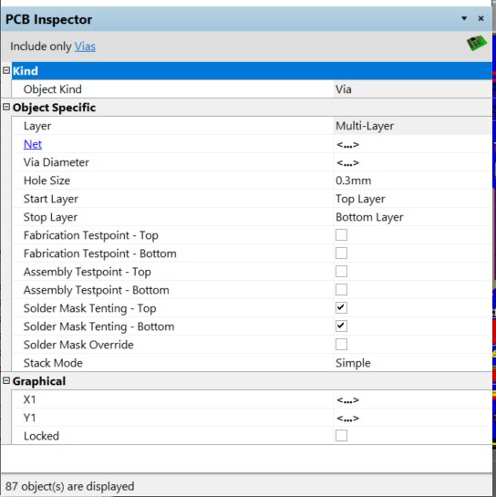

    I then tried the Object Inspector method and yes it worked. Thanks
    The method for others to learn:-
    So Select only via with Home->Via.
    Drag around the entire board to select all via's.
    View->Object Inspector and select the tenting options. Says Only Via's at the top.
    Close window.
    Generate the Gerbers.
    And in Gerbview (Kicad gerber viewer) has no Vias on the anti-solder mask layer.
