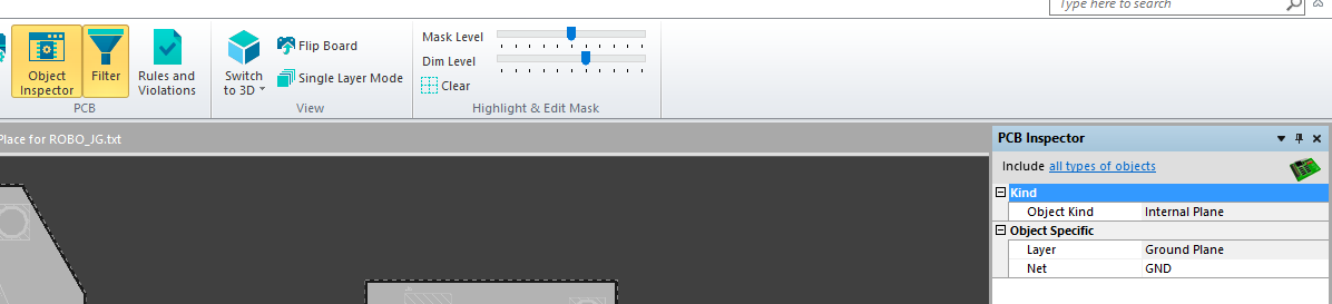

    Found the net name under the object inspector.  You can use the Filters to help show which layer is selected.  Then if you click the Ground Plane tab at the bottom of the PCB editor, you can then click anywhere on the layer.  in the object inspector you'll get this:

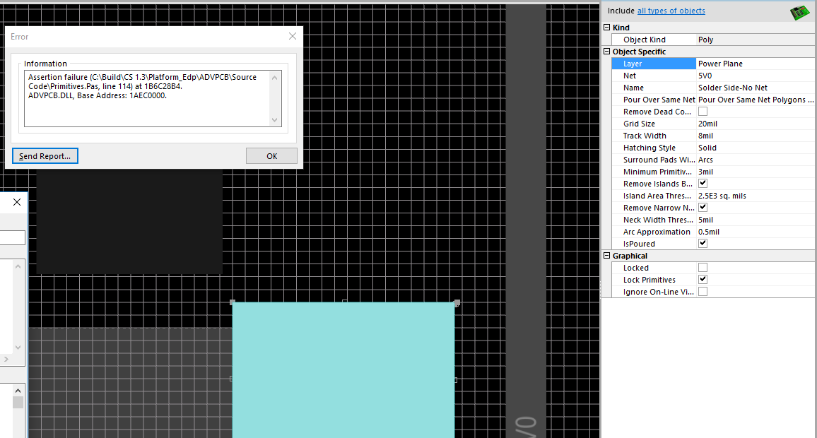

    I am trying to split the power plane into 3 separate polygons.  I drew a polygon on the power plane layer, and the software crashed 3 times and sent reports, etc. out.

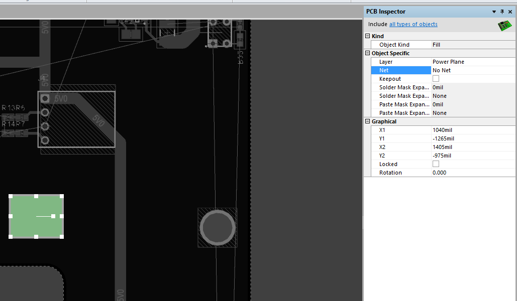

    here i've drawn a fill on the power plane.  I am trying to asign it to a net name using the object inspector, or by double clicking on the fill and selecting a net name.  every time i select a net name it automatically puts the field back to 'No Net'

    Here i tried to put a polygon fill on a different layer, set it to a net name, then change the layer to internal power - CS crashed

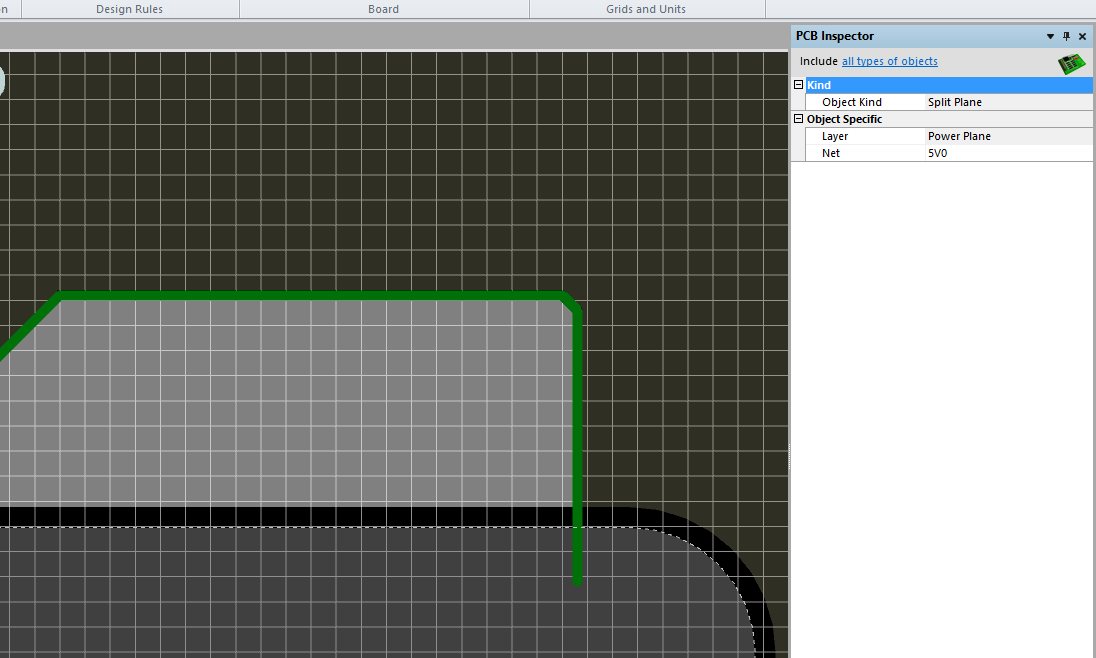

    I've got it figured out.  you can draw a Line.  if it sections off a portion of the existing internal layer, it will cut the polygon.  you can then select a different Net Name if you click on the sectioned off polygon. Here the main layer is 3v, now this new sectioned portion is 5v.
    the documentation on this is non-existent, and its not too obvious.
    in addition to that, the software had many crashes using the PCB inspector and so on - not great.  but at least it seems i have it sorted for the time being.

    You finaly found the right usage. Altium Designer and CS have two different concepts of layers. Signal layers and plane layers. Signal layers show the expected behaviour like the bottom and top layers.
    Plane layers are a kind of inverse layer. You draw the areas where no copper should be. As you explored, you can draw line segments to build areas similar to polygons and assign net names to them.
    Usualy these areas are called split planes.
    CS documentation for asisigning nets to splite planes can be found here : Split Plane | Online Documentation for Altium Products and here : PCB | Online Documentation for Altium Products
    Further readings: Internal Plane Information | Online Documentation for Altium Products
    If you want do get a little deeper into the concept of split planes, take a look at the AD documentation here : Internal Power and Split Planes | Online Documentation for Altium Products
