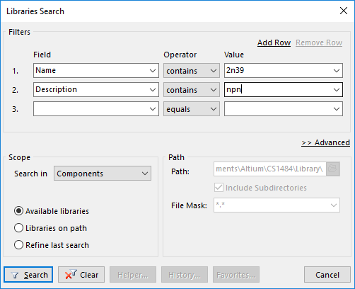

Whats more, When I use the 'Search...' button at the top center of the panel, it changes to 'stop' and I can't get it to change back to 'Search...'. I can't get it to 'stop'. This with or without a string in the filter (just '*') under the Libraries selection drop down list, and all Library Types selected in the Browse mode selector.
My understanding was that if I used the 'Search...' button, the Libraries Search dialog would appear, and when set searches all installed libraries and returns the results as 'Query Results'. If I just select the 'Miscellaneous Devices.IntLib' with an asterisk ('*') as my filter string I should get everything in that library listed in the Components List. I get nothing. (I've read the Documentation on the Libraries Panel here. I just don't get this functionality.)

    Also, if you click the Search button on the Libraries panel, the Libraries Search dialog appears. The search results are then displayed, showing Query Results on the libraries panel and can be filtered as described above.
    • The Field column specifies what field/parameter in the library to search. This defaults to Name.
    • The Operator column controls whether to search for the entire value or just part of it, or to search just at the beginning or the end. This defaults to equals, but is usually better to change it to contains.
    • The Value column is what to search for. This is blank by default. Using * in there will search all.
    A common search example, find a transistor beginning with 2N39:
    Field: Name; Operator: contains; Value: 2n39
    If another row is added, this will further restrict the search, because the two filters are AND'ed together. For example, add npn, so that only NPN transistors are found:
    Field: Description; Operator: contains; Value: npn
    However if you're wanting to find a string such as "darlington" in either the Name or Description to expand the search, they need to be OR'd together.
    To do this, click the link: >> Advanced and use an OR statement to search both the Component Name and Description fields, for example:
    (Name LIKE '*darlington*') OR (Description LIKE '*darlington*')
    Notes:
    1. The Scope, "Available Libraries" is a very fast search of the installed libraries so should complete quickly. If the Search button shows "Stop" for more than a few seconds, ignore it and feel free to click the Stop button to do another search.
    2. The Scope, "Libraries on path" is slower if the folder or sub folders contain a lot of libraries. Once a component is found, if you try to place it, a dialog will ask if you'd like to install the library.
    3. The equals Operator is case sensitive, so it's better to use the contains Operator, unless you're picking from the list of components in the Value field.
