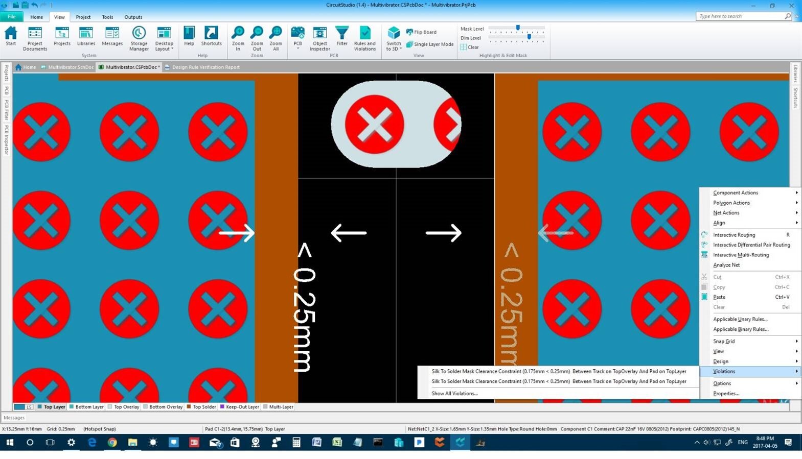

Running thru the Tutorial for the 2nd time, I noticed this - a DRC violation that shows one thing, but is caught by a different design rule:
This looks like a Copper to Silkscreen, not Soldermask to Silkscreen violation. Is this a bug?

    Hi Thomas,
    Please check your Silk To Solder mask Clearance design rule, if it is set to Clearance Checking Mode: Check Clearance to Exposed Copper. If so, then I think it's working correctly. If I'm not understanding this correctly, please attach the CSPcbDoc file.

    0 tlc8126 over 9 years ago in reply to jamesharrimanaltium
    James,
    Thanks, totally missed that. Works perfectly when set right! (That's why I'm going thru the Tutorial once more to make sure I don't miss these sorts of things.)
