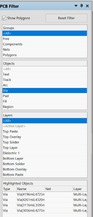

I would like to have my THole pads with a pull back of 3mils and the vias tented by -1mil. I can't see any way this can be done
as vias don't come up in the selections. You can It select each via and do it but that's crazy.
Does anyone know how to do this?

    1) You can select them with the filter tool.  First Reset Filter to get rid of any past filters. Then mouse pick View > Filter then choose groups <All> and Objects Via with Layers <All>.  Then only the vias should be chosen.  Use the mouse to drag a highlight box around them or press CTRL-A to pick them all.  Then View > Object Inspector gets you to the PCB Inspector tab. There is a checkbox selection ofr Solder Mask Override but there seems to be no value to set so it isn't clear to me what the check box does.  Tenting check boxes seem to work though.  Some fabricators do not want to tent vias both sides as this can trap chemicals.
    If you have different size vias it may be difficult to sort them this way.  In AD you can use advance filters to get specific ones by size.
