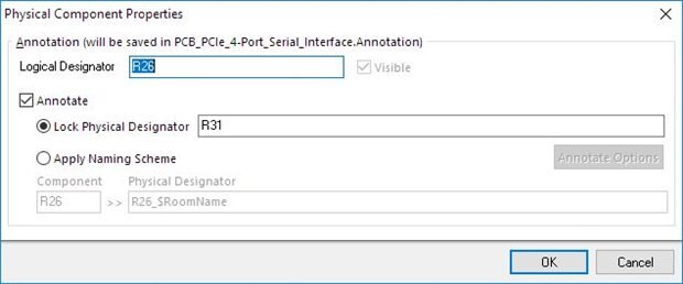

  • bugrobotics
    0 bugrobotics over 7 years ago in reply to e14softwareuk
    Hi Peter,
    How would one go about getting the behavior shown in the example project (PCB_PCIe_4-Port...) where the separate channel's components get annotated with a simple number?  The example project doesn't seem to follow it's own settings (Multi-Channel project options: $Component_$ChannelName).
    EDIT:
    Maybe a clue...I see where the annotation has been set manually (pic below).  Any ideas?
  • e14softwareuk
    0 e14softwareuk over 7 years ago in reply to bugrobotics
    Not sure you can reproduce the example board behaviour without manually assignment. It is possible to mess with the assignments to get just numeric designators like below. This might not be a great example given there seems great potential for name clashes.
