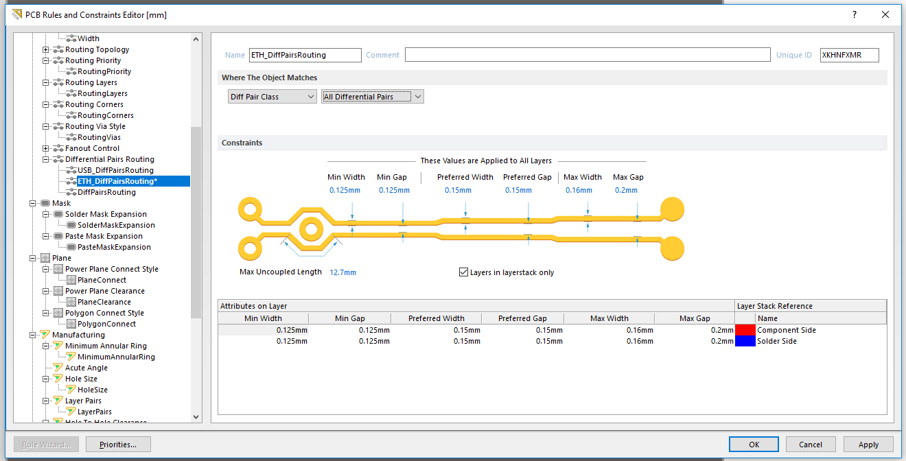

    Thanks for your answer, but it's sadly not what I'm looking for. Creating the differential pair is not the problem. As you can see from screenshot below, there is an option in the design rules dialog to apply a rule to a differential pair class, but I haven't found a way to create that class... I can only choose "All Differential Pairs", which is not at all what I'm trying to do.

    I ended up using the "Differential Pairs Editor" in the PCB Editor. After you specify your differential pairs, they will show up in the Differential Pairs Editor. From there you can use the "Rule Wizard" button and if you specify the same "Prefix" and "Differential Pair Routing Rule Name" (e.g. "ETH_DiffPairsRouting") for all pairs, they should end up in the same rule. So in the end I got a Design Rule by the name of "ETH_DiffPairsRouting". When you open your Design Rules, this rule will still be marked "Where the object matches" --> "All", but when you click on the rule category "Differential Pairs Routing" the rule will have a scope specified with all the differential pairs you chose earlier...

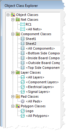

    Unfortunately creation of differential pair classes is not supported even in the PCB editor. Here's a screenshot of the class dialog showing the types that are supported.
