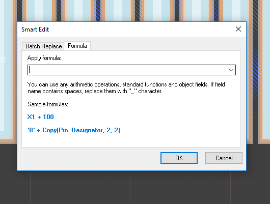

Does anyone know how to append a suffix to component designators? I have tried using both the SCH Inspector and PCB Inspector. I am following the examples in Altium Designer Help (since I can’t find anything in CircuitStudio on “Smart Edit – Formula”) on this page:
http://www.altium.com/documentation/15.1/display/ADES/PCB_Pnl-PCBInspector((PCB+Inspector))_AD
When I try the example given on that page, the result is all component reference designators change to  !+’_MEM’ instead of the original reference designator_MEM. Does anyone know if this works in CircuitStudio or does it only work in AD?

    The attached screenshot is from Circuit Studio 1.4.  When a formula is entered, even the example formula given, it doesn't seem to be evaluated properly.  It seems that if smart edit weren't supported, the menu wouldn't be there in the first place. This looks more like a bug somewhere in formula evaluation

    Sorry to revisit a very old thread, but just I've got a work around for this for anyone who comes across this thread. As with most things, it's a bit of a faff, but ultimately possible.
    If you copy and paste the components in layout, the designators will have _1 automatically added to them.
    From here, then it's easy to use the Batch Replace function to transform the _1 to something else, then delete the original parts
    To back annotate, you have to re link the components, Tools -> Component Links. Assuming you haven't got any stragglers in there, this should click through.
    Then, click Home -> Project -> Update Schematics in... to push the changes back to the schematics.
    Also, the first half of this can be used when place replicating when you add an extra channel.
    The formula function still does not work 2 years on... the tab shouldn't exist if it's unusable!

    Now, I think we might have a setting somewhere that differs, because when I copy and paste an existing component, I get the same designator - forcing me to either edit it manually, or do a re-annotation of the sheet. Do you happen to know where the setting is, that would allow me to get "_1" style designators on copy&paste?
  • hlovett
    0 hlovett over 7 years ago in reply to persilja
    Good timing then!
    If I copy a single component, I get what you see, just an exact copy. However, if I do multiple, then it appends the _1 on it. Hopefully that will solve your problem!
