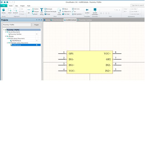

    Peter, I have watched the videos and read the docs and tried to associate footprint with schematic with no success.
    Here is what I have and have been doing.
    1) I have created a footprint from scratch called TSSOP8.PcbLib (using File > New document > PCB Library) it is stored in mypath/Altium/MyLibs
    2) TSSOP8.PcbLib is present in CS in the projects pane Proximity-1.PrjPcb>Libraries>PCB Library Documents>TSSOP8.PcbLib
    3) I have created a schematic from scratch called lm2903.SchLib (using File > New document > Schematic Library) it is stored in mypath/Altium/MyLibs
    4) lm2903.SchLib is present in CS in the projects pane Proximity-11.PrjPcb>Libraries>Schematic Library Documents>lm2903.SchLib
    If I highlight the lm2903.SchLib in the project pane, as shown in Fig 1 image

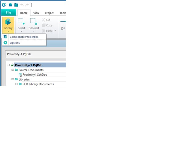

    Then use the Library to get to Component Properties, Figure 2

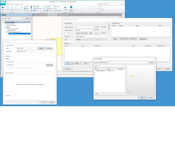

    This brings up many windows, Figure 3 that seem to be in the right direction, for example Pin Map… seems to map component pins to Model Pins, see below. However, I am concerned on two fronts
    1) Why is the name of the component PCBComponent_1 when I thought it was called TSSOP8?
    2) How will I know when the footprint and schematic have been associated?
    Figure 3image
    As far as I can tell (from videos and the documentation), none of the detail I’ve presented above is present in the documentation or support. Please can you explain how I may proceed to associate a footprint and schematic and test that the association has been achieved successfully.

    I think what's missing is the concept that a library holds many components, the name of the library is just a file name nothing to do with the footprint. Within the library you have many components and the name of these is important. You would have to rename PCBComponent_1 to be TSSOP8.
