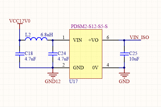

  • yadhu22krish@gmail.com
    0 yadhu22krish@gmail.com over 8 years ago
    GND12 and GND are two seprate grounds. I want isolation between them.

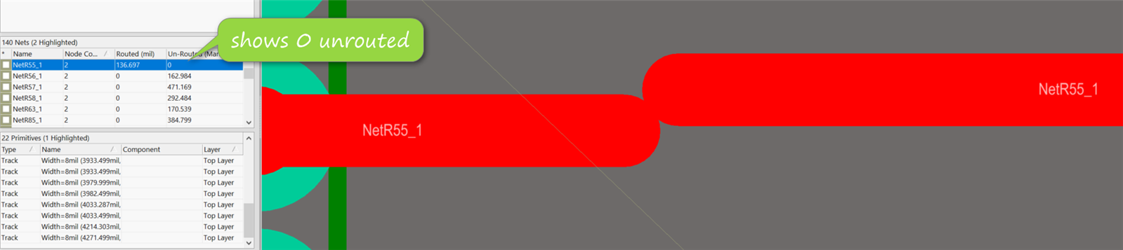

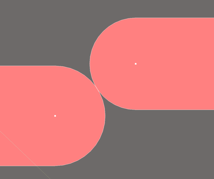

  • tarribred61
    0 tarribred61 over 8 years ago in reply to tarribred61
    While testing this feature I see a potential problem.  I made two segments of one net just barely touch each other and it is showing them as connected with 0 length unrouted.  However, if you did this on an actual PCB there is a chance it would have insufficient copper connecting these.  This might happen, for example, if you connected a net to a pad on a component and then nudged the component over such that the net ended up just barely touching the pad.
    Here is a close up showing the hot spots and just how poor a connection these might have but still say they are routed.  If I reduce the route trace widths just slightly then the unrouted connection length changes from 0 to 11.528mil.

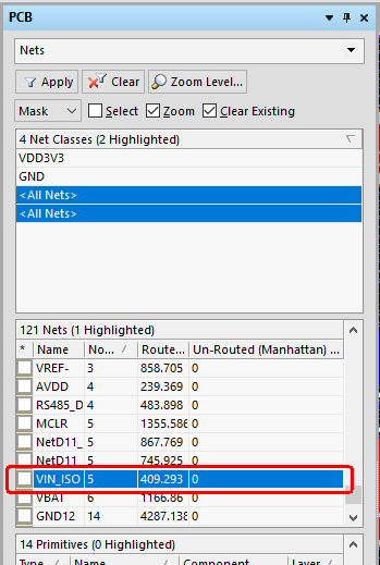

    0 yadhu22krish@gmail.com over 8 years ago in reply to tarribred61
    I have checked the PCB tab. Its showing routed.
