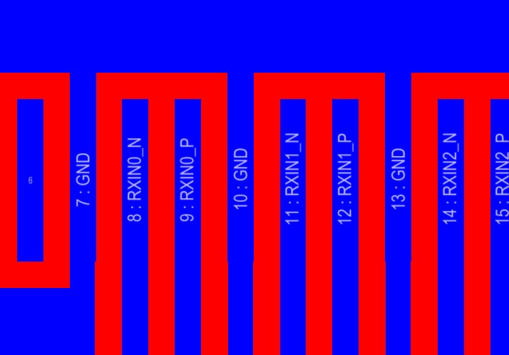

    In my situation, Atium did not connect some ground pads using the thermal relief as I would expect. Direct connect connects them as I want, but I want to keep the relief connect for the rest of the polygon. Here shown are the pads with the relief connect rule:

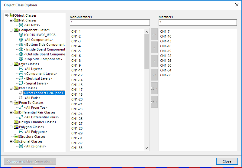

    I solved this by creating a specific pad class in the Object Class explorer: Design -> Classes -> Right click on Pad Classes -> Add Class
    And manually moved the pads that need the direct connect rule into this class:

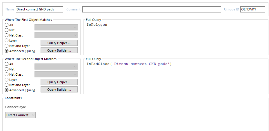

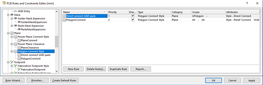

    Then I created a new polygon rule with higher priority (leaving the orignal rule that applies relief connect to the whole polygon).
    The new rule uses "InPadClass" on "Where The Second Object Matches"

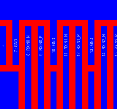

    The result is that the specified ground pads have been connected using direct connect, but it hasn't affected the relief connect on the rest of the PCB:
