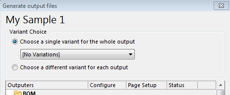

    Hi. When using Generate Outputs are you selecting a variant?

    Hi Peter,
    yes, I am. It worked fine for some components and wrong for others. So I assume I did this procedure correctly.
    I didn't have to go to generating output file, it was noticed also at the 3D view.
    It seams more like a bug for me.

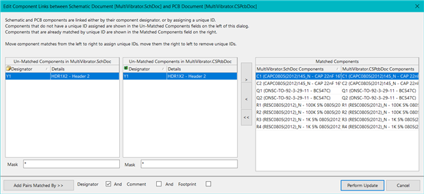

  • e14softwareuk
    0 e14softwareuk over 8 years ago in reply to lupal
    If swapping out and replacing components make it work then there is the possibility that the links between the schematic and PCB components had become outdated, possibly if you've been copy and pasting. If you encounter this issue again then the following will help you check and fix without the need to go around changing components.
    In the PCB editor select Tools | Component Links, this checks the integrity of the schematic symbol to PCB component links and brings up a window to allow any unmatched components to be fixed up. If there is anything in the two left columns then action is required, otherwise everything is good. If there are mis-matches then select a symbol in the first column and PCB component in the second column and use the right arrow button to confirm the match.
    Once all components are matched run an update from the schematic to bring the PCB up to date with any changes. Your variants should now display correctly.
