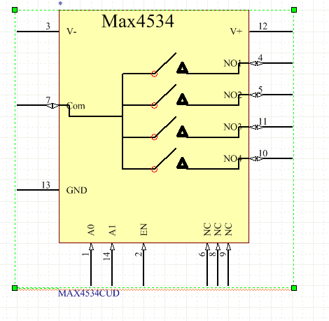

Hi,
Is it possible to mirror a schematic component?  I've seen references to "X" and "Y" keys to mirror over that axis, but those do not work.  The spacebar rotates the component, but I don't see a mirror.
I have a 4:1 mux:
I'd like to keep the control pins on the bottom, but have the common on the right and the 4 channels on the left.
Thanks,
Jim
  • e14softwareuk
    0 e14softwareuk over 8 years ago
    The X and Y keys do work but you need to have the symbol 'on the cursor', hold down the mouse on the component and then hit the keys. Alternatively bring up the property dialog and tick 'Mirrored'.
