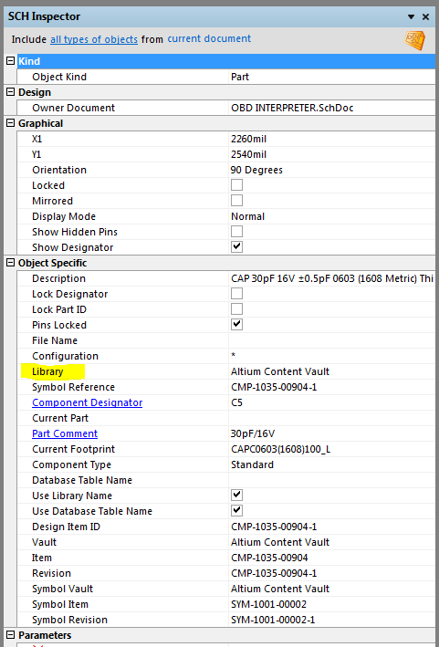

    You can view the library easily by activating the SCH Inspector panel using View | Inspector. Clicking on a symbol will bring up lots of useful information including the "Library" field.

    But what if I have two libraries with the same name?  For example, if I have one library that is saved within a project, and another library that is installed as a global environment library, and they have the same name, how do I know which library the part is actually from?
    Also, does the concept of a part "belonging to a library" even a thing in CircuitStudio?  For example, if I update the pcb footprint for a part in a library, it does not automatically update the PCB layout for that component in my project right?  In other words, the second you place an object, the link the library it came from is broken, right?

    Once a part is loaded onto the schematic from a library file the data is copied. I understand what you are saying with regards to "if I update the library..." but think of it this way - if you have a completed design you would not want it to randomly change if someone happened to edit a library you are using. From a library you can push changes through to the design files in a controlled manner.
    It would not be considered good practice to have more than one library with the same name, that would create confusion not just within the product but when managing the files at a file system level.
