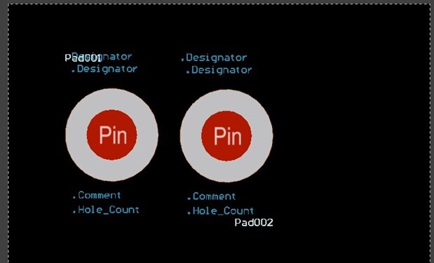

Hallo,
nach einiger erfolgloser Suche im Internet hier die Frage:
Ist es möglich das Textformat für den Designator auf der Leiterplatte (Top Overlay) zu verändern ?
Die Variante es per PCB Filter und PCB Inspector ändern zu können ist klar, allerdings wäre es besser, es gleich in den Komponenten vorzubelegen.
Zumal auch die Option "AutoPosition" offenbar immer auf "Manuell" steht und erst im PCB geändert werden kann.
Ein freier Text wäre auch möglich, aber ein Versuch mit ".Designator" wie ihn das Dropdownfeld anbietet, liefert im PCB nur genau diesen Text und nicht den Designator.

    Hello,
    this is rather surprising. I just tried the same thing again with an emtpy project and an empty component library. The standard Designator label is correctly displayed (the PAD002 was changed to "below-right" with autotext.
    But none of the "dot-Name" values are evaluated. see screenshot below.
    I hopefully tried all ways to solve it, such as "compile", "recompile", save source and project files.
    Is there some project option to be set ?
    To return to the initial question: IMHO the easiest way would be to offer the Designator dialog in the component editor. Or at least offer the Option "always display Designator" like in the SCH component editor.
    Are there plans to add either of them ?
    screenshot, showing the pcb plane with the added strings to be expanded. With .designator I tried ".designator" (with quotes) as well just to be sure.

    Yes, this is an image from the PCB document. In the PCB library you wouldn't see the standard designators.
    I'll sent the files in the next few minutes.

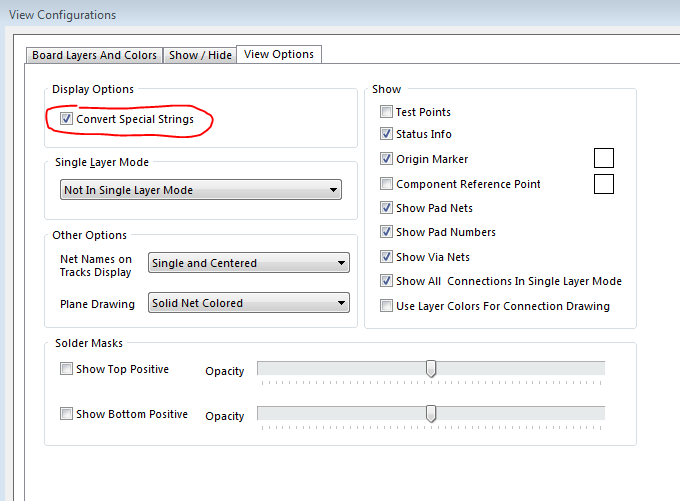

    Hi Henry. Can you check this setting in View Configurations (click near LS in lower left of window) and click on View Options tab.
  • henry.markert
    0 henry.markert over 8 years ago in reply to e14softwareuk
    Ok, that's it. It works now as expected. Thank you.
