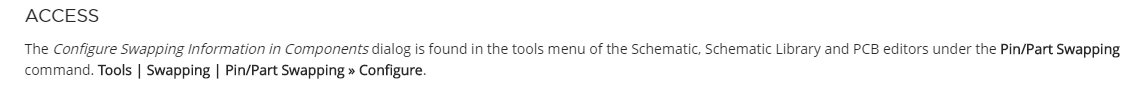

Can't figure out where the Pin/Part Swapping Command is supposed to be accessed from within the schematic library editor.
According to this page, it is located at:
See video:
https://youtu.be/FqbH3NuVjDc
