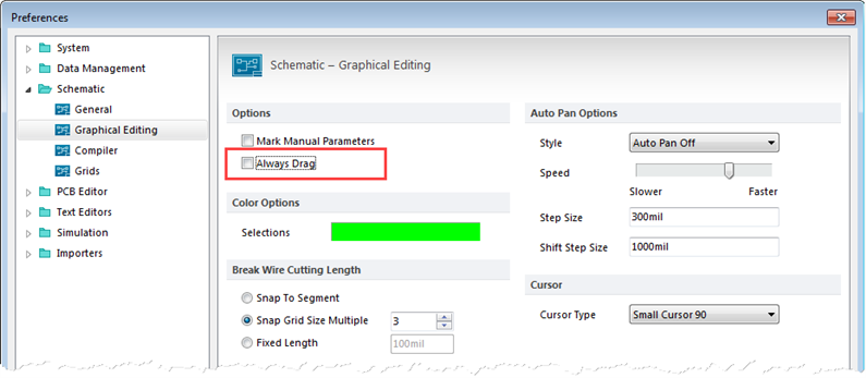

Hi i need turn off net auto connection when i move components from left to right. my problem is if unfortunately by moving components net stick they make connection. how i can avoid this?

    Hi. Assuming you are working in the schematic editor you can hold down the Control key when dragging a component - this moves the component leaving the wires behind. If you wish to disable the moving of wires along with components this can be turned off under File > System Preferences : Schematic > Graphics Editing > Always Drag.
