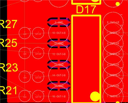

In the CS documentation, as well as in the videos https://www.youtube.com/watch?v=a8iPHimegdg&feature=youtu.be , filling polygons works correctly. I created a polygon in my project and try to fill it: as a result, only those terminals that have the same NET property are correctly connected to the polygon, and the rest are simply short-circuited.
I guess I do not have any rules? If so, show an example and what to look for?
Thankful in advance for the answer!

    Hi Sergey. My guess would be your design rules need changing. In the PCB editor use Home | Design Rules to bring up the PCB Rules and Constrains Editor. Check the rules you have for Electrical > Clearance…
  • e14softwareuk
    0 e14softwareuk over 8 years ago
    Hi Sergey. My guess would be your design rules need changing. In the PCB editor use Home | Design Rules to bring up the PCB Rules and Constrains Editor. Check the rules you have for Electrical > Clearance. Make sure to have a Different Nets Only minimum clearance and that the rules in the table below are sensible.

    Thank you! I changed the values in "Clearance", and everything turned out !!!!
