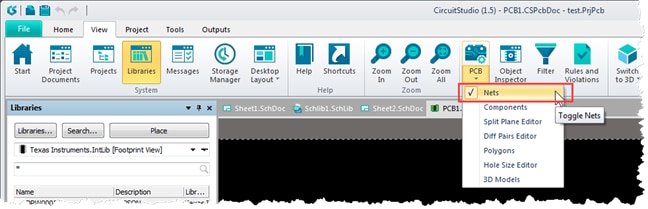

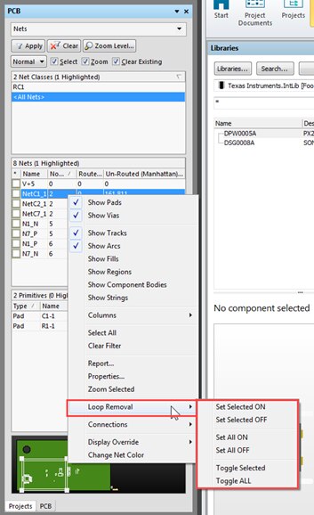

    Hi Tom. There are a couple of placed you need to check to make sure loop removal is turned on.
    #1: File > System Preferences : PCB Editor > Interactive Routing
    #2: Turn on the PCB Nets panel
    and then right click on a net and select the loop removal option
