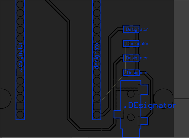

Hi,
I'm having an issue with the designator display in the assembly layer in Circuit studio.
They always show ".Designator" in the PCB editor, instead of the actual designator.
When I print the drawing however, I see the proper designators.
Does anyone know how to fix the issue? There must be some display option somewhere but I can't seem to find it.
Thank you

    To see the ref des values you will need to enable the "convert special strings" display option. There are a few ways to access this menu. 1) When in the PCB mode, right click on the window area showing…
  • tarribred61
    0 tarribred61 over 8 years ago
    1) When in the PCB mode, right click on the window area showing the PCB and choose the context sensitive 'options' then 'Board layers & colors'.
    OR
    2) left click on the color box on the bottom tabbed row of the layers
    OR
    3) Press hot key combo: SHFT + L
    Then choose the View Options tab to get the menu below;
    Check the box to enable the Convert Special Strings.
  • haythamhakla
    0 haythamhakla over 8 years ago in reply to tarribred61
    thank you,
    That's what I was looking for.
    Regards !
