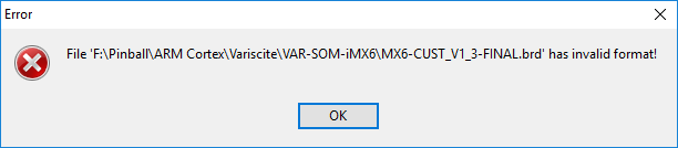

  I know there's another thread on this subject, but it's a year old and I don't have Altium Designer or OrCAD.  I'm trying to import files with the extension .BRD, .ALG and .DSN.  The .DSN file imported fine and I am able to use the schematics generated by the import.  However, neither the .BRD or .ALG files will import.  The company says that other Altium users use the files all the time and don't have problems.  I get this error:
  Are there any settings I can change in the File -> System Preferences -> Importers settings that would help with this?  Also, where does it log the events, warnings and errors?  Maybe the log will reveal something.  Any help would be greatly appreciated.

    Looking at the importer for CircuitStudio the BRD file is for Eagle - is your file an Eagle design, if so what version?
    If you are trying to import OrCAD then you can see in the above the list of file types supported. I believe that OrdCAD 16.3 or later is not fully supported by CS.

    Hi Tony. Thanks for sending through the .brd file and it is Allegro rather than Eagle. A bureau with Altium Designer should be able to import the .alg PCB file and save as Altium Binary 5 format that would be suitable for importing into CircuitStudio.
