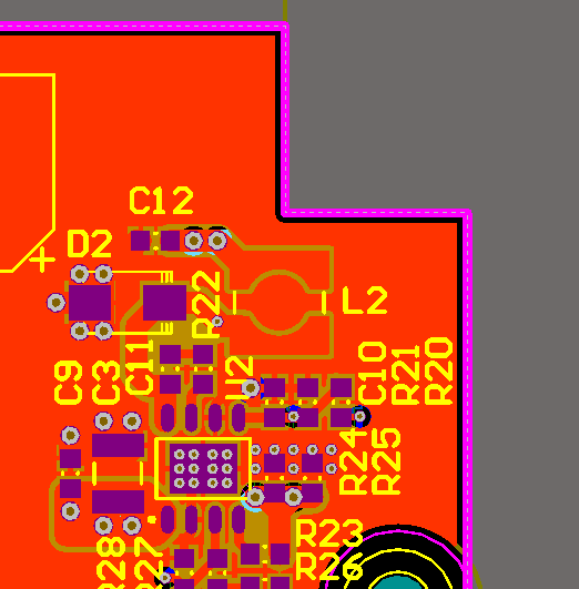

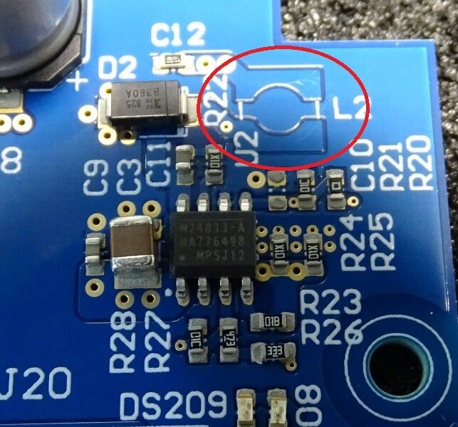

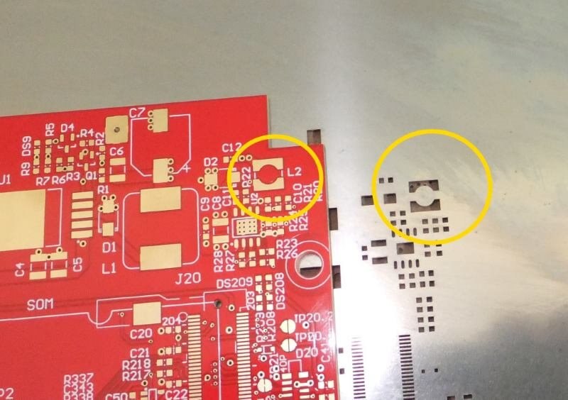

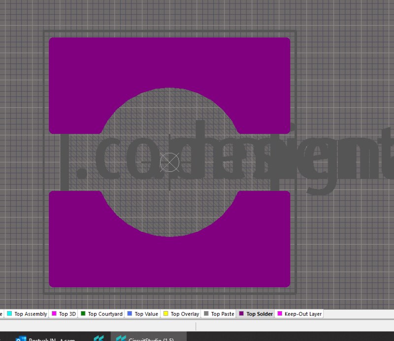

    0 Sparkylabs over 7 years ago
    A further bug. If I have a polygon pour in a solder paste layer assigned to a net it also covers other nets in what will be a massive short circuit!
  • voltsandjolts
    0 voltsandjolts over 7 years ago in reply to Sparkylabs
    nonsense input = nonsense output
