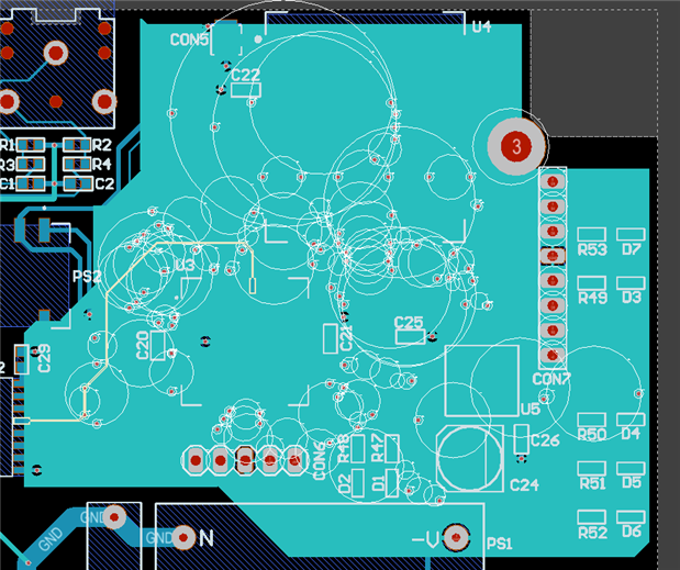

Hi everyone.
My settings on clearances are checked and re-checked.
On graphical panel the selected net for connection is the SGND, and "Pour over same net polygons" has been selected.
Then i draw the solid copper ground plane on bottom layer.
But with the SGND net all other tracks on bottom layer are also merged into plane.
Look at the short circuit violations on the picture.

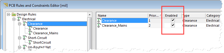

    Hi. Make sure you have no "0" values in your clearance design rules and also check the rules are enabled - this can catch people out because it is a separate tick box.

    0 photivs over 7 years ago in reply to e14softwareuk
    Thanks a lot
    Yes, the box was unticked.
