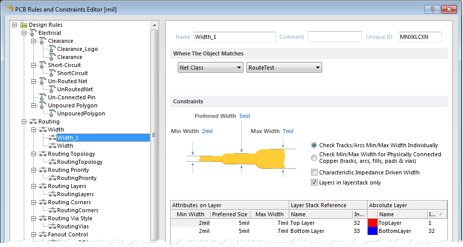

Hi Everyone,
I was wondering if there is a possibility in interactive routing to automatically use the widths that are defined in the design rules.
I have set up track widths in the design rules and tied them to different net classes. In the Schematics there are net classes tied to net's.
So is it possible, while interactive routing, that circuit studio uses the already defined widths for the tracks from the design rules?
This would really speed up working and even make less room for mistakes. Am I doing something wrong or missing out? Is it a feature for Altium Designer?
Regards
Jonas
  • e14softwareuk
    0 e14softwareuk over 7 years ago
    It is possible to set up net classes and assign routing width rules. You switch between widths when routing using shortcut "3".
    The order of rules is important as they operate on a first match basis so make sure your specific net class rules are first.
