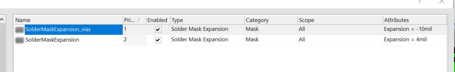

    Go to Mask>Solder Mask Expansion and then right mouse click and add New Rule; give it a name like SolderMaskExpansion_vias. Click Apply button.
    Observe the column that says Scope.  Is should say "All" or "(All)" for a value.  Change the attributes to a large negative value if you want to tent fully or to whatever you want it to be.  Here I have changed mine to be -10mil.

    For example, this is what I get from the default as the default.
    SELECTION=FALSE|LAYER=TOP|LOCKED=FALSE|POLYGONOUTLINE=FALSE|USERROUTED=TRUE|UNIONINDEX=0|UNIQUEID=ICMNQFCH|RULEKIND=SolderMaskExpansion|NETSCOPE=AnyNet|LAYERKIND=SameLayer|SCOPE1EXPRESSION=All|SCOPE2EXPRESSION=All|NAME=SolderMaskExpansion|ENABLED=TRUE|PRIORITY=2|COMMENT= |DEFINEDBYLOGICALDOCUMENT=FALSE|EXPANSION=4mil¶
    If you add another rule then you would get more entries.  Since, we added another rule above I get the following in my editor.  It isn't in a pretty and human readable format but it is in text.
    SELECTION=FALSE|LAYER=UNKNOWN|LOCKED=FALSE|POLYGONOUTLINE=FALSE|USERROUTED=TRUE|UNIONINDEX=0|UNIQUEID=AATYVYYQ|RULEKIND=SolderMaskExpansion|NETSCOPE=AnyNet|LAYERKIND=SameLayer|SCOPE1EXPRESSION=All|SCOPE2EXPRESSION=All|NAME=SolderMaskExpansion_vias|ENABLED=TRUE|PRIORITY=1|COMMENT= |DEFINEDBYLOGICALDOCUMENT=FALSE|EXPANSION=-10mil¶

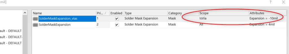

    You should see the scope of the rule change now to IsVia.
    Click Apply and then OK to close the Rules editor.
    If you view the PCB in 3D you should see the vias now have solder mask encroached with a negative expansion.

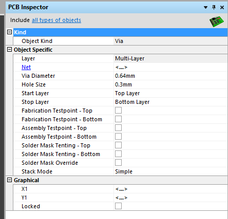

    >>Actually, the simpler method
    I would definitely agree with "simpler" in compare with the first post image if it would really work. There is no way to set a negative tenting for vias in the Object Inspector. ...And guys (from CS)... is it really modern user-friendly approach to set a negative value for "no open mask" instead of having a separate checkbox just for that? The same for paste.
    Also, selecting "all" vias is not what I need. Some non-routing vias should be with mask. Filters are useless here too.
    As for the workaround in a form of the Object Inspector, which seems is a way to go for many workarounds in CS I should mention it doesn't have all fields to edit that individual property windows have (just another example, but for the same subject: editing footprints, e.g. 64 pins of MCU for mask expansion value and some other properties).
