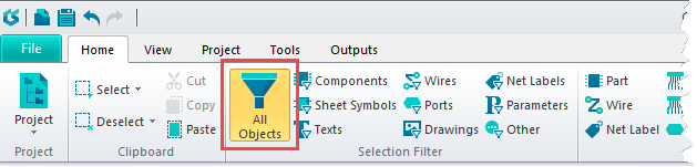

Hi,
When place a schematic symbol with designator and comment, it may not be possible to pick and move it.
As far as I know, if the text was placed automatically to Location X 712, Location Y 419, it can not move.
Designator and comment will be able to move when I modified ones place of Location to Zeros (710 and 410).
Basically default location has never been optimal. I always move all texts manually to best position.
Editing grid is very troublesome. How do you want me to do this?
Current Document Options settings:
[Sheet Options] - [Grids] Check_Snap 10, Check_Visible 10
[Sheet Options]- [Electrical Grid] Enable, Check_Grid Range 4

    Hi. I've tried to reproduce your issue but without success - I have no problem moving off grid text. One thing to check is that you don't have any filters in place that prevent selecting or moving objects.

    I can move all the text on the sample design. If I change the properties to move off grid then moving the text is still possible but usually needs CTRL to be held down when clicking on the text to move - this prevents the symbol also being dragged.
  • tyro01
    0 tyro01 over 7 years ago in reply to e14softwareuk
    Thank you very much! Problem solved. I was able to drag these texts pressing CTRL key image
