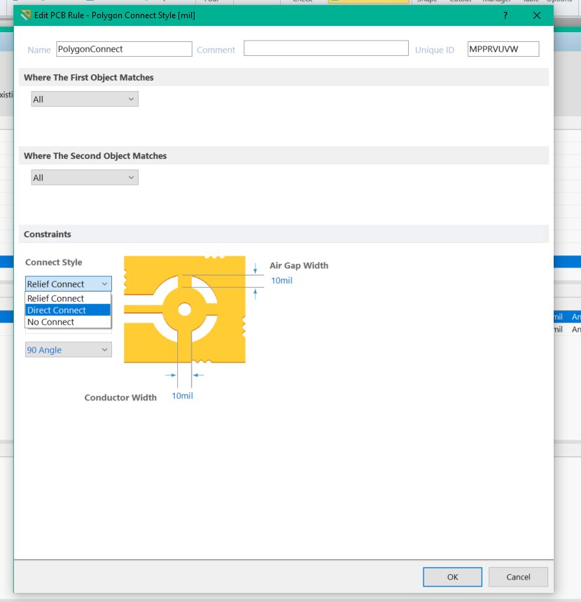

Hello, I am new to Circuit Studio. I have a few technical questions about the program that I can't seem to find answers for on line. The first one is... how do I connect a pad, either through hole or SM, to a ground plane?

    When you are in the PCB design (as opposed to schematic design) you would use a via to connect an outer layer pad to a ground plane on an inner layer.  If you instead mean a ground flood on an outer layer then you would place a net to connect these.

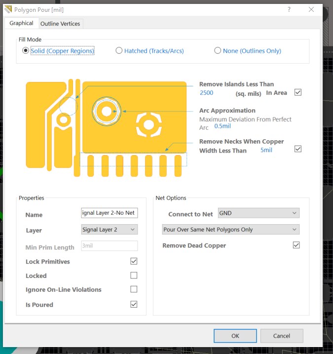

    Hi Thomas. Thank you for your help. As I stated in my question, I am new to Circuit Studio, so I really appreciate you taking the time out to help me. I will research the site you gave me. How would I construct a net in the PCB design mode? What I need to do is to pour a GND plane on my bottom layer and open up all the pads that need to see ground to it so that they connect. I'm just not sure how to establish a net for a GND plane.

    The basic answer to your question might be, once you define a copper pour area/shape on your layer you would configure it and assign a net name.  You might first draw the lines, arcs and such as primitives and then select them and use the Polygon Pour menu to define a Polygon Pour from the selected objects.
    Then select the pour shape and configure it as you want.  This will take some experimentation for you at first.
    To tie the component pads to the copper pour (or ground flood) you would need to specify how to connect as part of the rules.  In that case, it would be the Polygon Connect Style type of rule.  You might want a relief connect or direct connect or you can instead place nets to manually make the connection.

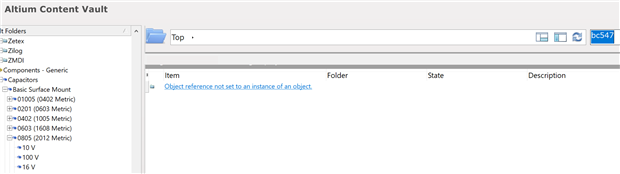

    0 alienjack over 7 years ago
    Hello Thomas and Peter.
    I am having another issue with Circuit Studio that I hope you can help me with. The issue is with the Altium Content Vault. When I search for a part, in the vault explorer,  I use to get a folder that was titled “All Folders” and the part I was searching for was inside that folder. I would click on the folder, it would open and the part list would appear. For some reason, this folder no longer appears when I do a part search in the vault explorer. Now what I get is a folder that reads, “ Object reference not set to an instance of an object”. I click on the fold, but nothing happens. It doesn’t open. Please see the attached screen shot. Do you know what might be causing this issue and how I can get back to the folder that use to say “All Folders”, so that I can view the parts that I am searching for?
  • tarribred61
    0 tarribred61 over 7 years ago in reply to alienjack
    Please see the several other related threads that have happened in the past week.  This seems to be a new issue that people are seeing.  We are waiting to hear from Altium on this.
  • alienjack
    0 alienjack over 7 years ago in reply to tarribred61
    Ok, thank you. It's very frustrating. It was working fine a few days ago then it started giving me issues the other day. Is there any thread that tells you how to correct the issue?
  • e14softwareuk
    0 e14softwareuk over 7 years ago in reply to alienjack
    We are waiting for Altium to investigate as the vault issue does seem to be affecting a number of people.
