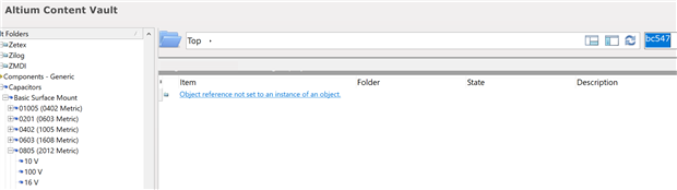

The vault seems to be having problems for some reason. When I search for a part e.g lm317 it just shows a folder symbol with a object problem message. it cant seem to find any parts at all..?

    0 alienjack over 7 years ago
    Hello Geoff,
    I am having the same issue. Does anyone know what can be causing the issue? I get this screen when I search for a part, but I can't open it. image
  • g_i_h
    0 g_i_h over 7 years ago
    I tried Peter Barnard says in his link above. Start CS and then go to the Vault. Select the search tab in the lower left corner of the screen and now use the search new search option. This still seems a bit iffy but it sort of works. This will not work at all if you try and use the top right hand search as you show. I have been using this software for a while now and this problem suddenly started for me.

    Thank you Geoff. This does seem to work, but I like the search in the Structure Tab much better. But at least I can search the vault again. I hope they resolve the issue soon.

    Please see my reply here: https://www.element14.com/community/message/281478/l/re-object-reference-not-set-in-vault-explorer#281478
