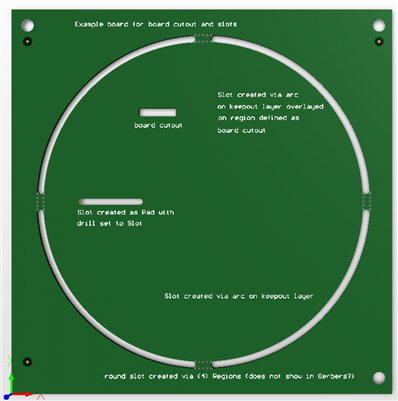

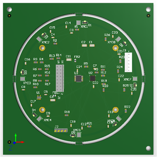

I must be overlooking some obvious step.  In the past I created (straight) milling slots by using elongated pads and that worked out well. But that doesn't work for arcs or other more complex shapes where I need to control the panelization (i.e. not simply defining the board shape in the gerber and let the board house do whatever it wants).
Using regions (created from primitives using the "hidden" Create region from primitives command) that I define as being board cutouts I get exactly what I want in the PCB editor. (slots are 2mm - default milling bit size, with tabs with 5-hole perfs).
I realize the board house will most likely want just the path for the router and not its actual shape, but I want to create gerbers with the routed slots so there's no confusion about inside vs. outside edge. As well as I like having the 3D view look like what I expect to get.
However when I create the Gerbers and NC drill files the slots don't show up in them when I examine them in my two viewers (GC-prevue and ZofzPCB).
Anyone have any guidance on creating slots like this?
Whatever board house gets used (most likely PCBWay) will have specific guidance (though I looked on their site and they don't for this case so if I do use them I'll obviously see what they want).  However at this point I just want to get a set of "generic" gerbers such that someone with a gerber viewer will see something that looks like the above rendering in CS's PCBEditor.

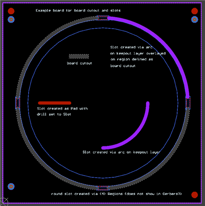

    If you draw arcs on the 'outline' layer they will appear in the corresponding gerber.  Outline is a mechanical layer and may not be enabled by default.
    I've done this successfully on a number of PCBs, if in any doubt I'll send an image of what I expect the board to look like.  However, CS's idea of what the board outline is appears to be separate, so the 3D preview doesn't automatically pick them up.  I think that a better (although slightly more involved) method advocated by Peter Barnard involves creating board cutouts, although I never quite got the hang of creating arcs just the way I want them.

    I made an example file (attached ) with regions defined as board cutouts arcs and rectangle), along with some arcs drawn on the keep-out layer, which is what the board house wants. There's also a slot made by adding a pad, which works fine for straight lines.
    and CS renders a 3D view "as expected" (i.e. it ignore the keepout layer but the cutouts show):
    But the generated Gerbers don't show the board cutouts in the 3 viewers I tried.  And they are not in the slot file, only the pad created slot is in that.
    The arcs do show in the keep out layer, and the board house will know what to do, etc.
    To me though this seems like a bug, i.e. what's the point of a "board cutout" if it doesn't end up in the gerber/NC drill data? Or is there a setting somewhere? (I've googled a bit but have not turned up anything)
    My workaround to get 3D renderings that are correct and gerbers the board house can use is to put keepout layer primitives that are positioned on top of the "board cutout" objects. That seems like a kluge for something that should be a somewhat common use case when dealing with non-square boards? If anyone has a better solution please let me know.

    @Frog Thanks for looking at this.   I restated my problem, which is basically agreement with your observation that there's no simple way to get the 3D rendering to match, i.e. board cutouts don't show in the Gerbers (so what's the point of them?) and you can't say "make the primitives on layer X render as cutouts".
    So for now my workaround is use both overlaid on each other: board cutouts to make the 3D right and drawn primitives on a layer (GKO in my case for the board house) so they know what to do.

      Looking back through some previous designs I can't immediately find anything that quite matches what you're doing, but I think I've come to the same conclusion that creating a board cutout and a superimposed feature on the outline layer is the only way to get the 3D rendering and gerbers to match.  I've also generated STEP files for our CAD designer - this has also taken some experimentation to get everything across in a useful form.

    However CS had other plans for me - yesterday one of the region board cutout slots (the upper right one) disappeared from the generated output.  The hint I had was in PCBeditor it was no longer filled with the light grey color of the other three.  However its properties were identical - there's exactly one property that can be set, and it was set to "board cutout".
    After a lot of WTF I finally ending up deleting that region and copy/paste/rotate one of the three still working ones in to its place.
    CS did go through one of its "I'm going to crash after every 10th mouse click for the next hour" fits and it might have been during that the cutout broke. Lesson: even if you place a region that's a cutout it can still fail to show in the CS generated 3D views. Look for the magical grey filling image
