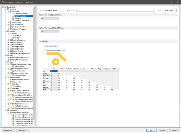

    The fix for your clearance problem will require some text editing but I guarantee it will work.   The following are the steps that you need to take:
    1-Go into your PCB Rules and Constraints Editor (Right-click and select Design --> Rules)
    2-In the Clearance section of the rules, duplicate the Clearance rule.  Name it Clearance_pogo or something like that.
    3-Give it a higher priority than the original Clearance rule.
    4-Export the Clearance RUL file.  Sometimes this gives me problems.  Sometimes it exports.  Sometimes it doesn't.
    5-Open the RUL file with a text editor such as Notepad++.
    6-Look for your Clearance rule that you just created.  Around the middle of the line it will have "NAME=Clearance_pogo".  It should be in the same order as the order in which it was placed in CS.
    7-Find SCOPE1EXPRESSION=All.
    8-Change "All" to the following:
         HasFootprint('Pogo PAD')
         Except "Pogo PAD" will be the name of YOUR footprint.  If you need to know what it's called, double-click on the footprint in CS and you will see the Name of the Footprint.  Copy and Paste that name.
    9-Save the text file.
    10-Import the RUL file into CS as a Clearance rule.

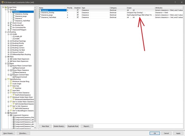

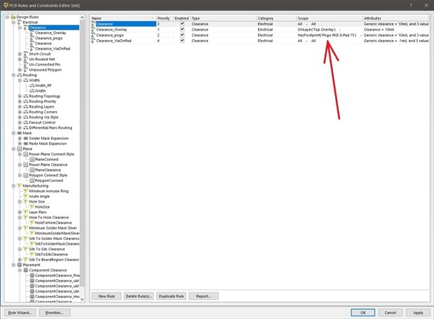

    11-In the rules you will see that both scopes utilize "All" in the drop-down menus but this will not be the case.  Don't change these values.  Click on the Clearance Heading and you will see that the first scope shows "HasFootprint('Pogo PAD')"
    12-Repour your polygon.
    Extra-If you don't wish to utilize a clearance for a particular rule, you can just delete the number.  It should then use the following Clearance rule.  Here's a pic.

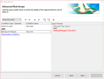

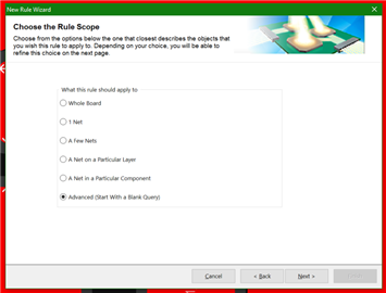

    You suggestion is good so I gave it a like.  I'd like to mention that there seems to be 'some' capability in CircuitStudio for defining advanced rules that gets to some of what you mention. If you open the PCB Rules and Constraints Editor, then launch the Rule Wizard feature, you can enter the name and comment and then choose the rule scope as Advanced.
    In the next window it allows entry of conditions for scope.  There is partial query builder function from the AD tools here.  In the case mentioned, I could choose first condition as Exists on Layer and then Top Layer and the Query preview enters OnLayer('Top Layer').  Then I could add another condition, Belongs in Polygon and query preview fills in InNamedPolygon('***') with a drop down box that shows some of the polygons I have created and named.
    After you generate a rule this way there doesn't seem to be a way to edit the scope through the GUI but you can do what you suggest and export to a text editor, update and then re-import.
