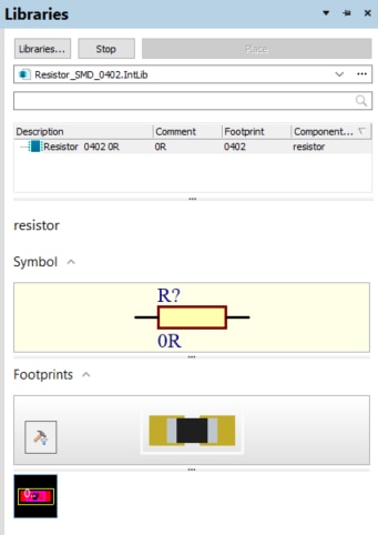

I'm trying to create an integrated library with more than one component.
I have created a 0402.pcblib and a r_0402_0r.SchLib r_0402_10k.SchLib r_0402_1k0.SchLib
I created a Resistor_0402.LibPkg and added all four items.
They appear to work within the library, but when I compile them into an integrated library only the first one appears and is selectable.

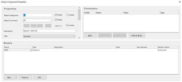

OK, I then tried the SCH Library Panel to add them there.
This now allows multiple components in the library. imageimage
BUT you cannot rename them to be the correct name.
in properties:-
There is no way to change the component name?image

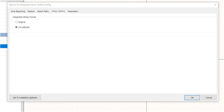

    However,  I did notice that in the options for Integrated Library window there is a tab and selection for Integrated Library Format with an original and a CircuitStudio setting.  I'm not sure what the difference is.  When I tested, it would not compile without error on the original setting but seemed to work on the CircuitStudio setting.

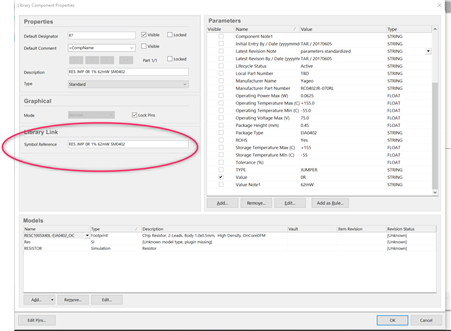

    To rename a part I would typically use the Library Link > Symbol Reference text.  Just click in the field and edit.  When the properties window is closed it should rename in the library.  But it doesn't look like you have that Library Link section in your screen shot.

    Thank you Thomas for answering my question.
    You gave me some good pointers. Changing the name of the component was the key to it, As the Dialog hides this from view I had no idea it existed.
    Once I changed the names of the components to be different It all started to work etc.

    I agree the integrated library vesrion type made no difference.

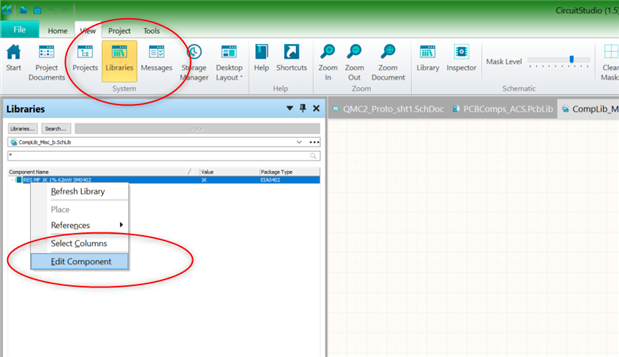

    The last comment about Edit Component does not exist in 1.5 for integrated libraries.
