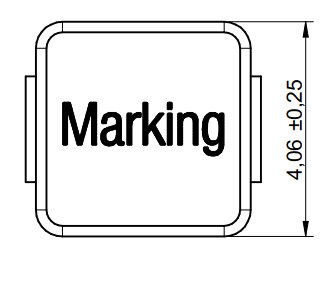

I want to create radiused corners for objects and fills but I don't see how to do that.  I can create a chamfered corners but is there a way to modify the chamfer into a radius?
For example, how would you create an accurate geometry for an assembly drawing of this part:
Looks like it need about 0.5mm radius.  I can how it might be done by making up four Arcs but that seems very tedious.
Thanks,
Stuart

    hello,
    If you are good in planning and thinking ahead, you can create the round corners during drawing-time with the line-tool.
    start drawing the line, left-click 0,5mm ahead of the corner (to end the first segment), on the keyboard switch the corner mode with SHIFT-SPACE to round corner (and with SPACE alone the corner-direction), set the next left-click on the end of the round corner. And so on for all 4 sides.
    But for me this works not very well. I'm migrating from Eagle (and actual I use both tools parallel - confusing), and there its easy to throw in a rough sketch and then refine. So I can see the result of every step and decide what to do next. I like little steps.
    My practice on CS is actual:
    - draw the rectangular outline, judge the look: good?needs improvement?
    - improvement needed: mark the complete drawed rectangle, all 4 cornerpoints on the wires are highlighted. Drag on everey corner-point to get change the 90°-corners into chamfered corners (your solution above). Work with the right grid-setting, so all 4 chamfers have the same length.
    - again: judge the look: good?needs improvement?
    - ok, it really needs the round corners: Left-click on all 4 chamfers, hit DELETE on the keyboard. Chose the wire tool and set the corner mode to "round corner" (SHIFT-SPACE), draw 4 round lines from every existing line-endpoint to the enxt starting line-starting-point. It helps the set the Hotspot-snapping mode (SHIFT-E) and the show-single-layer-mode (SHIFT-S), so theline-drawing-tool snaps very easy to the existing line-endpoints.
    This instruction seems long for such an easy task (and in this special case the existence of a specific chamfer/rounding function like in Eagle is easier), but I have tried to write down every little detail.After some drawn and modified rectangles the CS-workflow is ok (not great, but acceptable).
