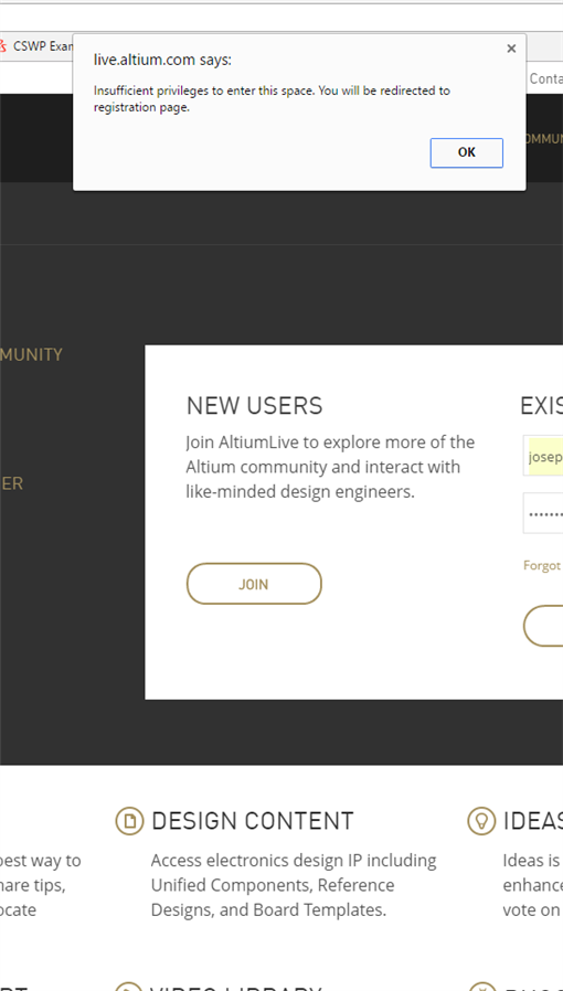

  • mflux_gamble
    0 mflux_gamble over 9 years ago
    Also, i see no way to download the vault libraries from Altium.  Here's what i get for trying to sign into the altium website:
    they do already have my email address on file - presumably from when I purchased circuit studio.  so i cannot make a new altium live account using the same email / user name as my CS account.
