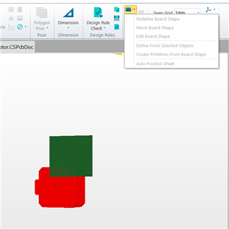

Pretty new to CircuitStudio. I have watched the tutorial "CircuitStudio Quick Start Webinar Series Part 6 - Importing enclosure .STEP Files". According to the tutorial I should be able to use the  Board shape->Define from 3D body button. I don't have this option in the list. Anyone that know if this have been removed?

    My colleague and I were just about to post the same question.  We have been using 1.3 for a while and successfully were using the "Define from 3D body" just as the tutorial video showed.  And now in the same project all the options in the Board Shape button are greyed out in 3D mode.
    Hopefully just a bug because if this ability was removed we will definitely have to rethink our strategy with design software.

    Hi Patrik and jstrautman,
    This is an unintended bug and we'll return this functionality in a hotfix update which we're working on. In the mean time you may want to consider installing 1.3 alongside to use to set the board outline. You can leave both versions installed and licensed on your machine.
    The board outline can also be converted to primitives which can be copied from one board to another. So if you'd rather not edit the board in an older version, open a copy of your board in 1.3 and set the board outline from the 3D body. Open the copy in 1.4 and convert the board outline to primitives. These can then be copied to your main board and selected. Then set the board outline from selected primitives.

    0 jstrautman over 9 years ago in reply to jamesharrimanaltium
    I did the steps you mentioned with v1.3 and it did indeed work well.  Would still like to see that fix that you mention, but keeping both versions will work for now.  Thank you!
