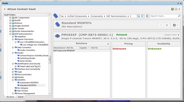

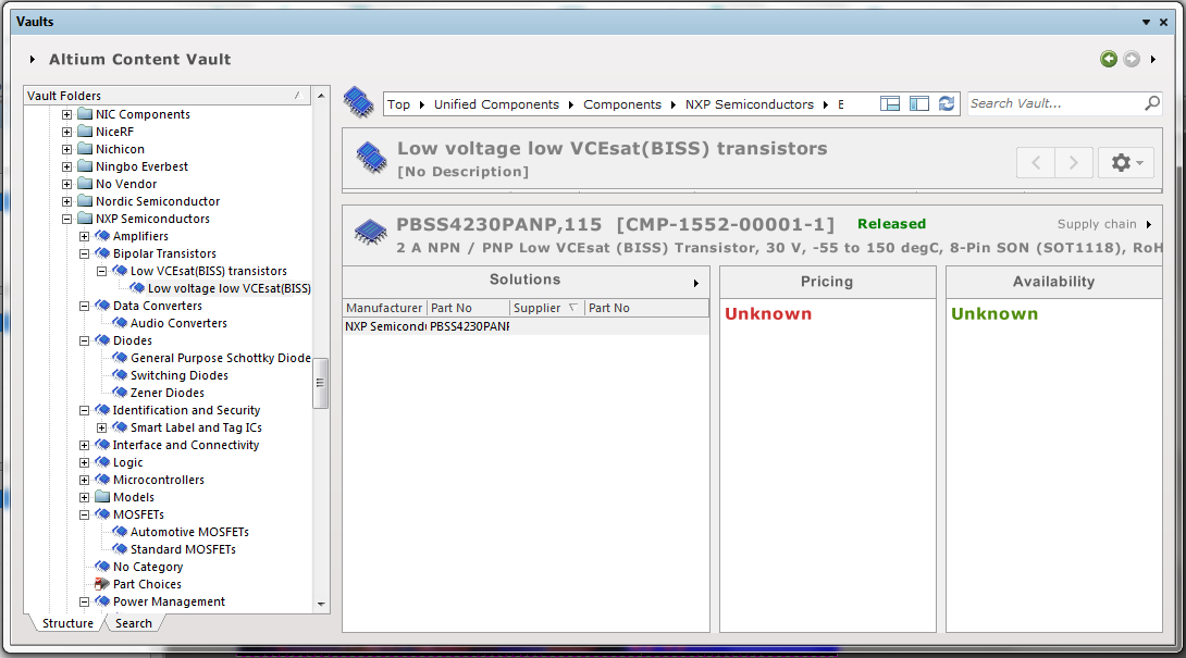

Hi,

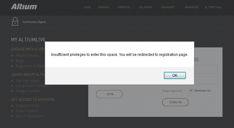

My main incentive in moving over to CircuitStudio is improved part management ... I was interested in the idea of the "vault" and easy access to 30,000 professional symbols, widely used by the Altium community.
Perhaps I am missing something obvious, but the Vault seems rather ... bare?  For example in NXP (who have a huge range of power semis) there is 1 transistor listed ... TI have one single DSP .... AVX have just 4 capacitors ... I was hoping for a little more comprehensive coverage.  Is the Vault a work in progress and still early days, or am I missing something obvious and just need to click a button or add a URL to gain the rest of the vault content?
I did find some libraries on the "Altium Live" site,  unfortunately I am unable to access them, as when I click it says "Login to download" .. I login and it says "Insufficient privileges to access this area" or something similar ... "click here to register" .... so I click to register and it says "that email address is already in use" ... which I know it is, as I just logged in with it.   ...

    e14 Contributor over 9 years ago in reply to e14softwareteam

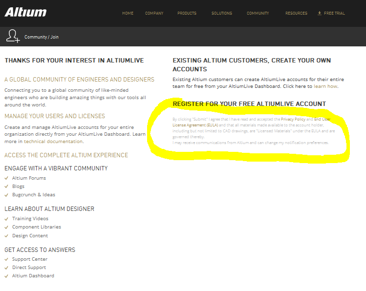

    Hi,
    As mentioned, what you suggest is not possible.  I already have a registration on that site, if I try to register, it tells me my email address is already in use, which is correct, it is .. so I log in and I get:
    It sends me to the registration page, which says "by clicking submit ... etc" ... and there is no "submit" button ...
    It is simply not possible ...

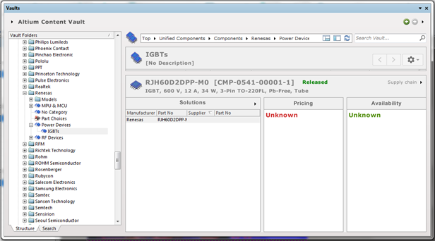

    Big thanks to James for contacting me and showing me how to find  parts libraries.  image
    I've now found lots of the parts and footprints I was struggling with. imageimageimage

    Design Content is available for anyone who registers, directly from the designcontent website, but actually does not require an AltiumLive account.
    It's not immediately obvious, so here are the instructions to do this:
    1. Open https://designcontent.live.altium.com/#UnifiedComponents in your browser.
    2. Register with First Name, Last Name, Email address and PCB Layout Tool
    3. Receive the email containing a link and use the link in each web browser that you intend to download content.
       - a cookie will be saved in the browser so that you may download other libraries without registering each time
       - repeat for each type of browser you wish to use, e.g. Firefox or Chrome
    4. The file downloads as a zip archive. This must be extracted to your drive prior to use in CircuitStudio.
       - e.g. click on the downloaded *.zip file and copy and paste the *.IntLib (Integrated Library) file to a folder on your PC.
    5. Drag the *.IntLib onto CircuitStudio and Choose Extract Sources
       - the Projects panel will show a LibPkg project containing a SchLib and PcbLib file.
    6. To allow CircuitStudio to locate the footprints during updating the board, these two files should be installed in the Libraries panel, or alternatively you may drag these two files into your project.
       - the upcoming CircuitStudio 1.4 is expected to work better with libraries that are not installed or are not installed in the libraries panel.
    7. Edit the libraries. Often you only want one device when you've downloaded the family
       - you may choose to copy the one Schematic component to your own custom library
       - don't forget to also copy the corresponding footprint(s) from the downloaded PcbLib to your custom footprint library.
       - edit the originals or copy and paste to make your own versions.
