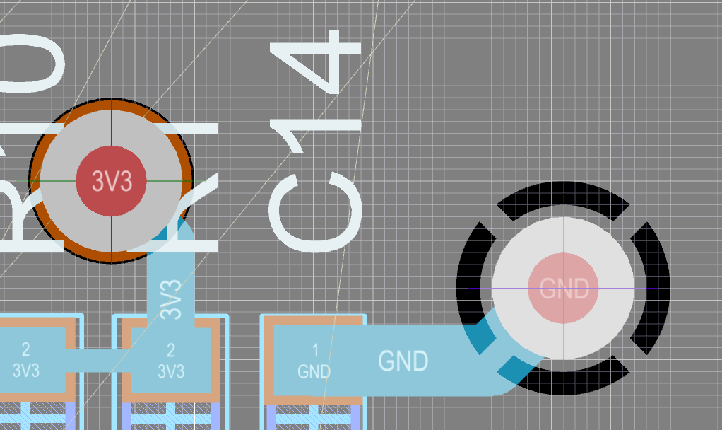

I had questions about splitting a power or ground, etc. plane on an internal layer - which are more or less answered here:
How to Assign Net Name to Internal Layer
That finished, there seems to be no way to edit the polygon pour options on these internal layers - so you're stuck with whatever clearances, cutouts, and tab connections to vias that are hard coded in CS?  what?
here's a screen shot of the feature I want to edit:
you can see that this is the GND internal plane that is highlighted in gray.  You can also see a power plane 3.3V via to the left.  The GND via clearance and connection - the perimeter is kinda huge, and the connection is thin.  maybe I want to edit that.
More worrisome is the 3.3V via clearance. looks small - although i see how the via diameter isn't the same in the internal layers.  That being said, some of the boards that I design, have HV on the internal layers, where clearance needs to be under My control.  how can we edit these internal layer polygon pours?  its important!

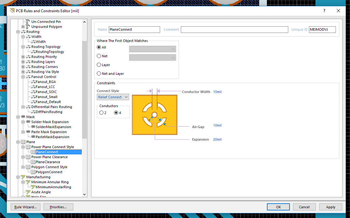

    The parameters you are looking for are no polygon pour parameters.
    You can control this things with design rules.
    Take a look at your design rules. You may want to edit the following rules:
    • Power Plane Connect Style | Online Documentation for Altium Products
    • Power Plane Clearance | Online Documentation for Altium Products
    I usually connect vias directly to the internal planes due to lower impedance.
    Maybe you want to introduce net classes (like a HV - net class) to customize your design rules for the different nets.

    nice!  thanks.  The options are indeed on the design rules under Plane
