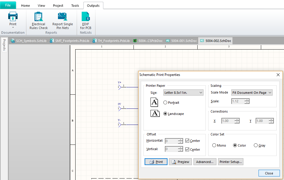

I can't get the batch job generate outputs function to allow me to make a color PDF of the schematic.  I have found where I can make the schematic mono, color and grayscale for individual prints, but I don't have the full version of acrobat...so it seems the only way to make a PDF is through the batch job where the schematic is stuck in grayscale.
Here's where I can batch output the schematic, but no color options seem to be available.

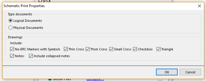

The options I get when I "Configure" the schematic print.
This panel affects individual prints, but I don't want a hard copy.  I need the batch to follow the color setting I've set here...

  • harvie256
    harvie256 over 9 years ago in reply to jstrautman
    You are much better off just hacking the OutJob file, when you print to a PDF you're rending a image then compressing it.  The file size ends up much bigger (like 20x) and you loose the great capability of auto generating a complete and bookmarked document stack.
    All you have to do is open the <project name>.OutJob in your favourite text editor and do a search and replace for "PrintKind=1" to "PrintKind=0". Save it and you're now generating colour docs.

  • jamesharrimanaltium
    jamesharrimanaltium over 9 years ago in reply to spe672
    Page Setup dialogs are being added to CircuitStudio in the up coming version 1.4. In the mean time it's no problem for you to hack the OutJob file carefully as described by harvie256 as this won't conflict with the up coming feature.

    Yes the 1.4 version is in Beta and assuming all goes well it should be only a few weeks away!
    The most amount of changes are related to the already excellent EAGLE importer, which will be getting even more features/improvements in CircuitStudio 1.4.
    Along with some other bug fixes we're also adding some minor features such as the Net Class Directive to Schematic so you can specify a Net Class on power nets for example, and update them to the board. In PCB we're therefore adding a Classes dialog so that you can edit/view the Net Classes, and added Net Class support to the appropriate rules.
    And as I mentioned earlier we added Page Setup options to Generate outputs files allowing, for example, color PDF outputs, but also other page setup settings you may want to change.
