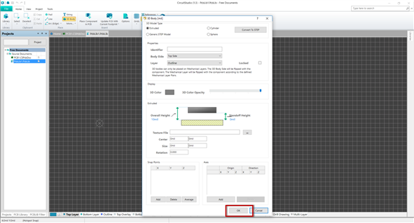

    Add this is what I have been doing but I am not get (or seeing an OK button)
    see screen shot below
    The dialog box is so big it will not display,  I have to more the task bar
    You can see the file I selected
    I do not see the OK button.  Not sure if it is not presenting it do to error or it is off page
    Is the a way to reduce the dialog size ???

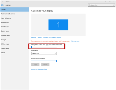

    solidcore over 9 years ago
    Hello Brian,
    I do see this problem whenever I am on a Windows 10 machine due to the new DPI configuration. Unfortunately, some windows of CircuitStudio does not scale itself according to the new DPI scale in Windows 10. As a workaround, please perform the following:
    1. Go to Start >> Display Setting
    2. Change the DPI to 100%. Without clicking on OK, go back to Circuit Studio
    3. You should now see every software's window change with respect to the 100% DPI. In Circuit Studio, you could now see the OK button when you click on 3D body.
    4. Obviously your window is now too small to be workable if you do not have an external monitor. Thus, after you are done with placing 3D bodies, please go back to Display setting and revert it back to 125%.
    Please let me know how this goes, thank you.
