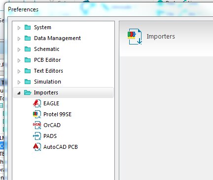

    This is not exactly related to he original post, but how do I install the .dxf importer.  When I go to File->Import .dxf is an option, but .dxf is not listed  in my system preferences.
    Thanks,
    Jim
  • e14softwareuk
    e14softwareuk over 9 years ago in reply to jimmallabar
    You may need to install the DXF importer, this is supplied with CircuitStudio but may not have installed automatically.From another post on the issue (note the file path will depend on where you chose to install CircuitStudio)
    "You may need to uninstall/reinstall the installation of TeighaX, the installer is located at C:\Program Files (x86)\Altium\CS\System\Installation\TeighaX_Setup_3.9.0.msi. TeighaX is a 3rd party utility used during import of dxf/dwg."
    Also check View > Start (Home) > My Account > Extensions & Updates : Configure... to see a list of installed importers and make sure DXF is selected.

    I checked "My Acount > Extentions & Updates" and found "DXF and DWG" is checked.  Do I need to have that unchecked when I install the TeigaX utility?

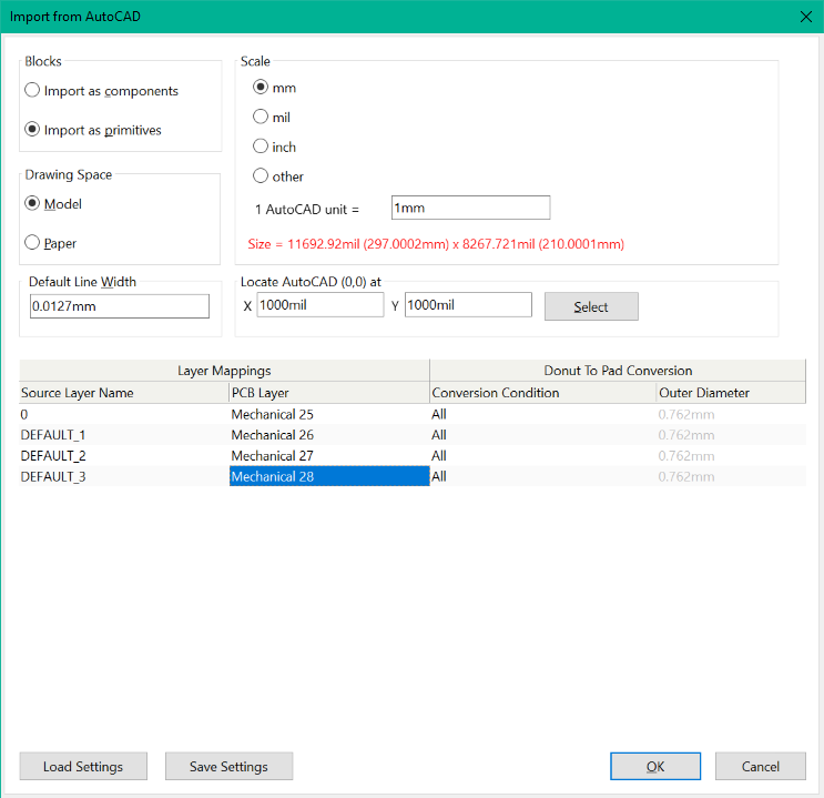

    1. I go to a blank PCB.
    2. File > Import and navigate to my DXF file
    3. I've tried all combinations of Blocks (components/primitives) and Drawing Space (Model/Paper)/
    4. I've selected several Scale options, "inch" makes the size the correct size, but the text turns red when I do that.
    5. image
    6. I've tried a couple of options for Layer Mapping, from leaving it all as default to setting all Source Layers to PCB "Layer Mechanical 3"
    7. I always get an Information Box indicating "Done".
    8. After I click "OK" I get a little spinning wheel for several seconds, and then nothing.  None of the mechanical layers indicate that that they are used.

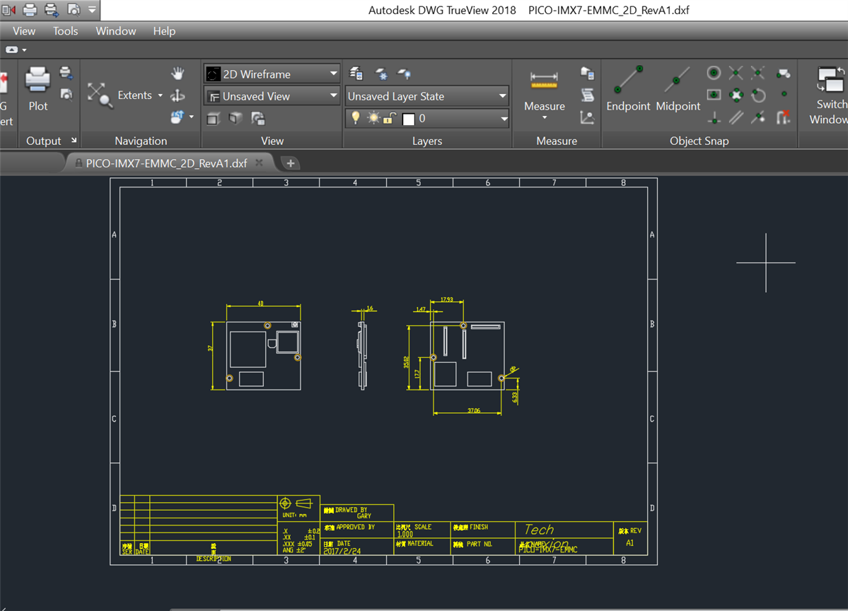

    The attached dxf file as a zip (if it goes through) should be able to import as the following settings.  The source layer 0 is the only one with information.  The other layers don't seem to have anything on them.  You can see I imported them into different mechanical layers.  Hopefully, you know the scaling of your DXF.
    If you look at this in AutoCad or Autodesk DWG TrueView you will see something like below.
    This came to me from a vendor that makes single board computers.  The sheet symbol, text and module outlines are dimensions end up on the same layer.  That's not ideal but it is at least an example you can try.  After I import this, the text is askew.  However the line art for the board outline and dimensions appear correctly.
